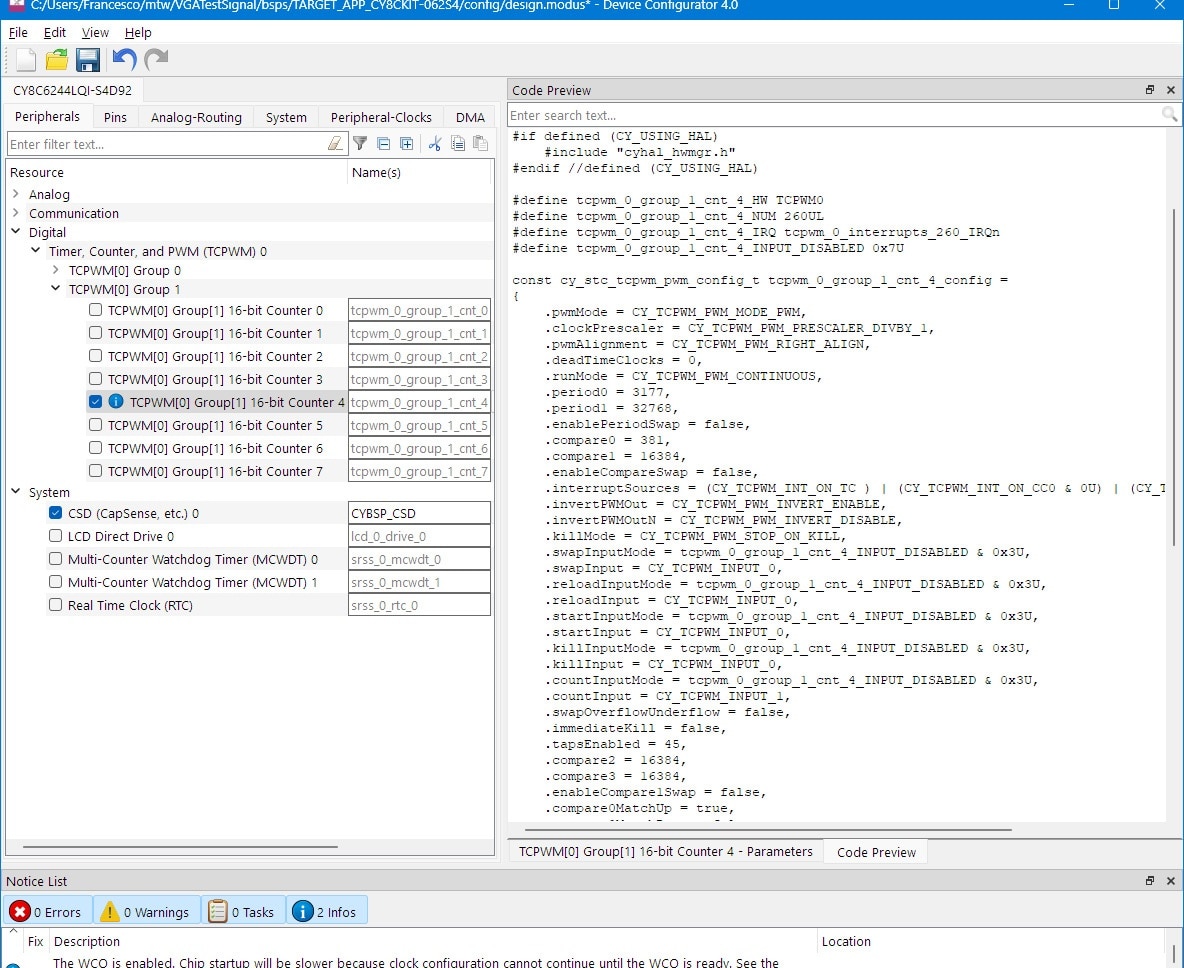

The ModusToolbox is really good for the configuration of peripherals and offers the "Device Configurator" for this purpose. A TCPWM counter needs a clock source to work, so I need one to set up and assign it to the TCPWM peripheral.
I have selected the TCPWM 0 Group 1 Counter 4 because it's an alternate function of the pin P9_0 as stated in the datasheet.
pin P9_0
Next, I enabled the TCPWM 0 Group 1  Counter 4 and selected the PWM counter type.
vga tcpwm pwm
Now it's a question of setting the parameters that I calculated before. So I need to set some parameters:
  • the period of the counter  = 3177.
  • the right-aligned "Counter Compare 0" value  = 381.
  • the overflow interrupt (when the counter overflows the period value).
  • the polarity of the PWM wave inverted (so the wave starts HIGH, then the pulse is LOW).
  • the PWM output line = P9_0 pin.
Done, don't forget that everything defined here will be "global" and can be used in the project:
