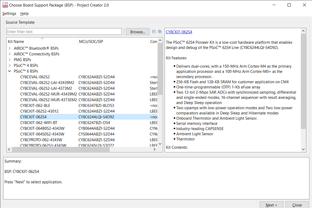

Setting up Modus Toolbox 3
  1. Connect your PSoC 62S4 pioneer kit to your computer using a USB cable.
  2. Open Modus Toolbox 3 and click on "File" in the menu bar, then select "New" > "ModusToolbox Application".
  3. In the "Select Project Type" dialog box, choose "PSoC 6" and click "Next".
  4. In the "Select Board" dialog box, choose your PSoC 62S4 board and click "Next".
  5. In the "Configure Application" dialog box, choose "Dual Core Application" and click "Next".
  6. Follow the remaining prompts to configure your project settings, such as choosing the programming/debugging tool and selecting the peripherals you want to use.

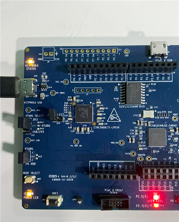

In this example, both cores of the PSoC 62S4 microcontroller are utilized to blink the onboard LEDs, P2.5 and P2.7. The Orange LED connected to P2.7, which is programmed on the CM4 core, blinks every 250ms, while the Red LED connected to P2.5, programmed on the CM0 core, blinks every 1000ms.
With Modus Toolbox 3 and the PSoC 62S4 Pioneer Kit, we have successfully set up a dual-core application. In our next blog post, we will discuss the different sensors required to build a baby monitor and how to interface them with this hardware. Thank you for reading, and please stay tuned for more updates.
