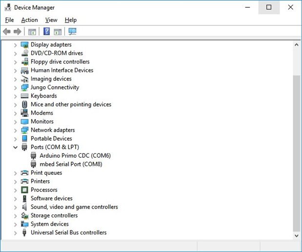

As we all know it is customary with any new MCU dev board to start with uploading a simple blink up project. However, in my case this did not start off very well. I discovered that a previous MCU USB driver install, which went wrong at the time, has come back to bite me. So, when I connect my micro:bits to my PC via USB cable, I do not get the virtual folder. This is rather essential as you need it to dump your compiled hex file.
So out went MBED and the simpler Microsoft blocks editor, which I had planned to start with – as why over complicate things.
This left me with only one option, which was to figure out how to use the Arduino IDE to develop my application and flash my micro:bit devices. Thankfully, I quickly learnt that Adafruit had a fantastic tutorial that guides you through the process. This can be found here: https://learn.adafruit.com/use-micro-bit-with-arduino
Then, I solved my problem by downloading the mbed driver – not quite sure why this worked for me as I have Windows 10 but it did. This at least provided my Arduino IDE the correct port to flash the firmware.
As you can see from the following images there are 2 serial ports. It is worth noting for others that one is used for flashing and one is used for the serial monitor.
