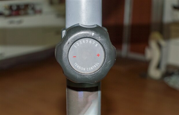

3. It turned out that the tension of my exercise bike depends not only on the position of the tension knob, but also on how quickly one or another "gear" was switched on and even of what "gear" was turned first, for example:
  • switching 6 – 7 – 8 – 7 gives the torque Te(A);
  • switching 6 – 7 gives the torque Te(B);
  • according to sensations, Te(A) > Te(B).

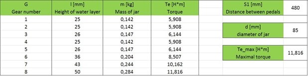

I was saddened by the current situation and even thought not to do the power calculation at all, but I still managed to find one solution: if we assume that the torque at the central axis of the pedal assembly of the exercise bike does not depend on the speed of rotation of the pedals, we can conduct the following experiment:
  • set the desired "gear" (G) with the help of tension knob;
  • put an empty cylindrical jar on the pedal;
  • fill the jar with water until the pedals begin to rotate;
  • determine the weight of water (m) in the jar;
  • determine the torque Te(G) by the formula:
Te(G) = 10 * m / (S1 / 2000)
where S1 is the distance between the pedal axes of the exercise bike (we already know that S1 = 480mm).
For the experiment, I used a cylindrical jar with a diameter d = 85mm, knowing that 1 liter of water weighs 1 kg, the mass of water in the jar can be determined knowing the water level l by the formula:
m = 3,14 * (d  / 1000/ 2)2 * l
As a result of the experiment, I obtained the following data table:
As I said, and as it can be seen from the table, it is not possible to define Te(G) precisely, for this reason I needed to approximate the value obtained. I performed the approximation with the help of my favorite program [Curve Expert], a polynomial of the second order. As a result of the approximation, the following model was obtained:
Te_a(G) = 5,49 – 0,26*G + 0,13*G2

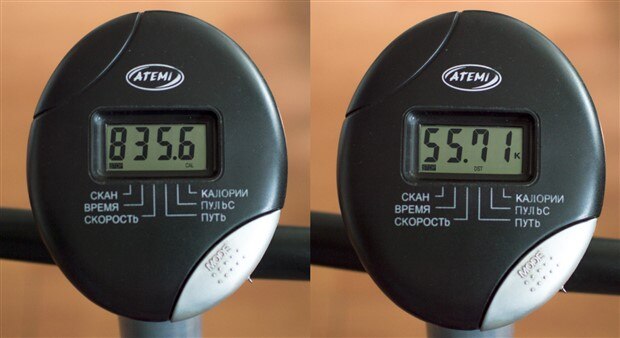

My old bicycle computer counts Pc(G, W) according to the following formula:
Pc3(G=any, W=Wn) = 835,6 / 55,71 * 32,0 = 479,97 ckal/h
The values turned out to be very close (difference of ~ 5%, taking into account all the assumptions made in the article, it is possible to write off the error of the method), so we take the following: when G = 8, the speed of my old bicycle computer (V3) – is true.
