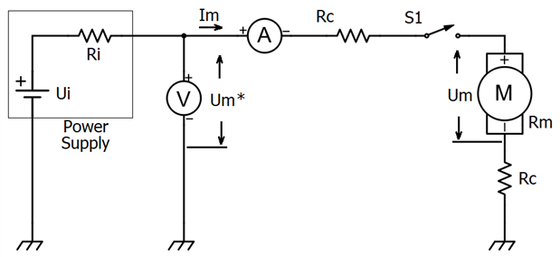

First, try to use this motor for its intended purpose. Below is a diagram of the experimental setup.
The motor that I decided to use is rated at 15 V. There was only one unit in my home workshop that could provide such a voltage. If you are interested in learning more about it, I offer you an article in which I quote its construction [link].
I conducted series of experiments and calculations:
1. I measured the resistance of the wire: Rc = 1,1 Ohm.
2. With the closed key S1, I determined the voltage Um* = 14.9 V, and also the current Im = 102 mA.
3. Further, based on the results of the experiment, I determined the voltage on the motor brushes  Um, for this I needed to determine the equivalent resistance of the motor Rm:
Rm = Um* / Im – 2*Rc
Rm = 14,9 / 0,102 – 2*1,1 = 143,9 Ohm
Um = Rm * Im
Um = 143,9 * 0,102 = 14,7 V
4. Knowing the current and voltage I determined the motor power on idle:
Pm_1 = Um * Im
Pm_1 = 14,7 * 0,102 = 1,50 W
5. I repeated steps 2-4 for the short circuit mode and got the power Pm_2:
Pm_2 = 5,19 W.

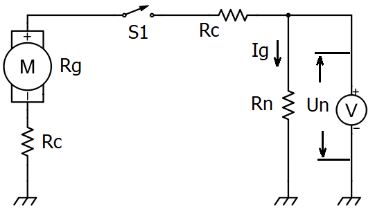

Power generation
For a low load experiment, I connected a load resistor Rn = 10 kOhm to my motor as follows:
Experiments with a high load, I conducted at a resistance of Rn = 100 Ohm.

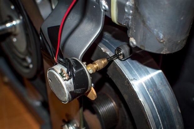

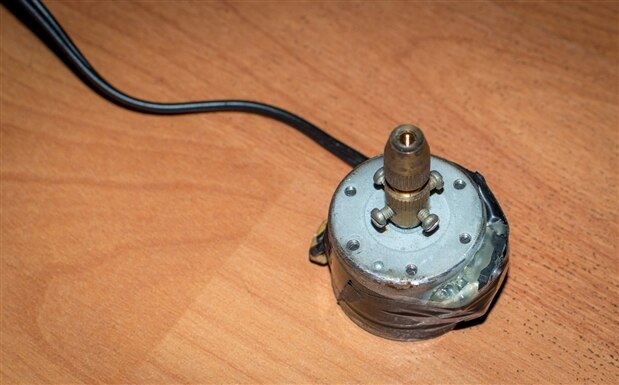

To pair the electric machine with the exercise bike, I installed a collet chuck on the motor shaft, in which in its turn was inserted a Dremel [model 407] nozzle designed for sanding. The fact is that if you remove the skin from this nozzle, it is a rubber wheel, ideal for connecting an electric machine with an exercise bike.

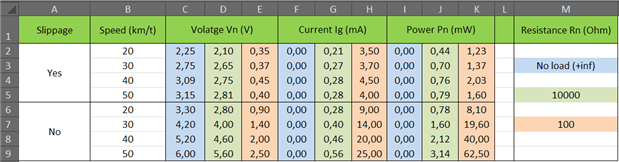

I reduced the test results to the table:
Battery charging
The results of the experiment upset me a little, because the maximum voltage that I managed to get by "muscle power" is 6.0 V. Under load and at a speed of 30 km/h, the voltage dropped down to 1.4 V. This voltage can not be used to feed battery, because charging it requires a voltage of 3.3 – 4.2 V (for 1S LiPo).

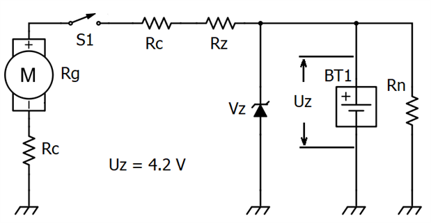

We have three possible solutions to this problem:
  1. Considering that the FRDM-KW41Z board consumes very little power, you can do nothing and simply connect the generator to the battery through a resistor and a Zener diode at 4.2 V. It is necessary to select a resistor in such a way that the voltage on battery is at least 3.5 V.
  2. You can solve the problem with a DC-DC converter, for example using the [LM2621] chip.
  3. The most correct solution is to use a multiplier (aka step-up reducer). If we increase the engine speed by only 3 times, we are supposed to be able to get stable 4.2 V at a load of 100 Ohm (i.e. 0.18 W). A further increase in RPM will allow us to enter the normal mode for my electric machine and get the calculated 1-2W.
I went the first, easiest way – and now I have though a small and low-power, but simple and reliable system of autonomous power supply!

    1. You are right - on low speed I cant get a maximum power of the generator because power of this type of electrical machine is proportional to RPM.
    2. Problem with slippage was associated with an insufficient clamping force between the flywheel and the rubber wheel. I solved this problem by installing an additional load.
    3. You are right - the large rubber wheel even more reduces the power of my generator.
    4. I really want to change the magnetic load to the electromechanical load, but this will be a completely different exercise bike image
    mcb1 over 8 years ago
    yuritikhonov
    Nice update and demonstration of the issues.
    One figure not shown is the free running speed of the motor.
    Unless you can rotate the generator at close to the required speed, surely it will not produce full power?
    I suspect that some of your slippage issue is caused by the mechanical coupling.
    You have a very small surface area between the drive surface and the fully loaded generator, along with no ability to increase the pressure on the rubber wheel.
    You may want to try a larger rubber wheel and have the generator much closer to the wheel, so you can add pressure to stop it slipping.
    Unfortunately that also slows down the rotational speed of the generator shaft, so you gain and lose. image
    In theory you should be able to spin the flywheel using the motor, but it could be a little underpowered and require the magnetic drag to be removed.
    This will prove the slippage has been eliminated.
