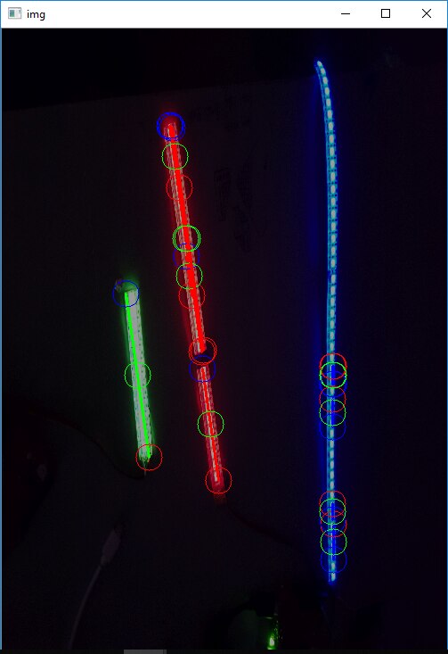

Hi all, this post will elaborate on the use of OpenCV-based image analysis for the Animator project. As you may remember from a few weeks back, I managed to get some nice results recognizing LED strips in pictures with OpenCV, but I needed more precision. I finally managed to get some decent results and I'm going to explain what I did and how. First, the results:
Here you can see three LED strips on a minimum brightness setting, utlising the current version of the config pattern. It's pretty simple for now - the first Animator that connects with the Beagle Bone gets colored red, the second gets green and the third goes blue. When the user uploads a photo of the setup, OpenCV finds its orientation (horizontal vs vertical) and relative positions of LED strips, returning a list of three numbers based on the elementary colour it finds in the picture - [0, 1, 2] means that the strips are ordered red, green, blue from left to right (or top to bottom - that information is stored elsewhere) - [2, 1, 0] means it's the opposite order, and so on. This allows the web interface to map user's inputs to their respective LED strips - the user doesn't care if the LED strip they want to configure is the one that connected to the central unit most recently, but they'd be very happy to just say 'hey, make the leftmost strip blue'. The primary goal of this project was to enable them to do exactly this, and if 30 seconds later they rearrange their physical setup, they should be able to just take another photo and work with the web interface as if nothing happened.

Future goals
You probably noticed the attention-catching circles littering the image - I didn't have enough time, nor memory in the Blends, to introduce recognizing direction of the strips, but coupled with some decent maths that'd allow for even nicer features - imagine LED strips emulating water droplets sliding from slopes, with each droplet's speed determined by the angle the LED strip is hanging from. That's a future goal and the circles in the image mark the beginnings, middles and ends of each line detected by OpenCV, for the purpose of colour recognition. The future idea is to make the configuration mode patters exhibit three colours, so that the LED strips' individual colours would be recognized together with their direction. This is not implemented now.

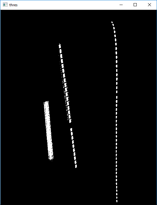

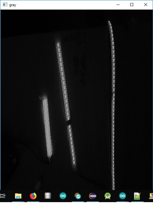

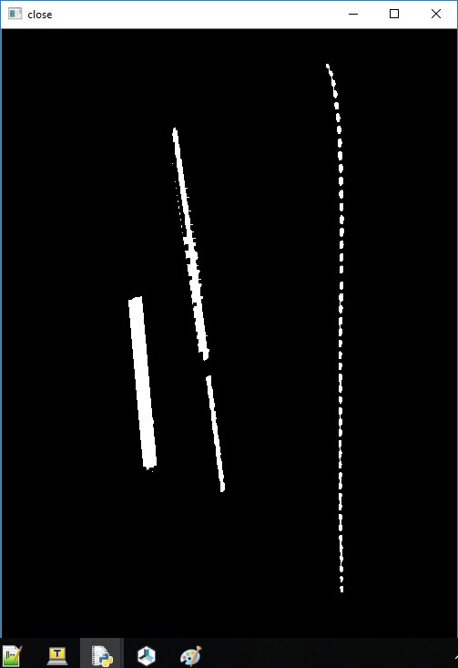

Step-through
Here's what happens to the image at each step of the process:
1. Opening, resizing, converting to grayscale
2. Thresholding
3. Closing gaps
While we could definitely improve, this is enough for the probabilistic Hough transform to detect a decent amount of lines. Naturally, for the colour recognition, we come back to the full-colour image.

Stage one: Number of analysed line, coordinates on the centre, mean colour content of the 30px-wide area around the centre, dominant colour (1=red etc.), total number of lines found per colour.
0: 206x235 R: 59  G: 17  B: 27, 1 r 1 g 0 b 0
1: 234x443 R: 86  G: 36  B: 45, 1 r 2 g 0 b 0
2: 371x388 R: 13  G: 36  B: 93, 3 r 2 g 0 b 1
3: 372x575 R: 12  G: 32  B: 90, 3 r 2 g 0 b 2
4: 210x277 R: 119  G: 38  B: 42, 1 r 3 g 0 b 2
5: 371x430 R: 15  G: 35  B: 94, 3 r 3 g 0 b 3
6: 208x235 R: 47  G: 20  B: 25, 1 r 4 g 0 b 3
7: 194x143 R: 121  G: 22  B: 29, 1 r 5 g 0 b 3
8: 371x541 R: 22  G: 32  B: 89, 3 r 5 g 0 b 4
9: 372x388 R: 24  G: 44  B: 92, 3 r 5 g 0 b 5
10: 152x388 R: 63  G: 75  B: 65, 2 r 5 g 1 b 5
Stage two: Averages of each colour's X and Y coordinates, factors used to find strips' orientation (sum of X differences between lines' starts and ends, same for Ys)
Rx: 210.4  Gx: 152.0  Bx: 371.4 Ry: 266.6  Gy: 388.0  By: 464.4 horz: 131 vert: 1053
Let's make a decision - is the dimensional shift larger in X than Y on average?
vertical.
Sort the colours in a dictionary based on average Xs (we don't care about Ys anymore) and print the dictionary:
[('g', 152.0), ('r', 210.4), ('b', 371.4)]
Stay tuned for a video demo in my final blog post!

    mgal over 8 years ago in reply to aspork42
    Hi James,
    Thank you for asking. I convert to grayscale to get shapes (i.e. coordinates of where the lines start and end, as well as their centres), then I find dominant colours in the original coloured picture using those coordinates. A lot of OpenCV algorithms work better in grayscale - see my 'Exploring OpenCV' post for some more details on that. If you take a look at the code, the 'src' object is the grayscale image, algorithmically modified in the lines 7-18 to get the coordinates, and then we get back to working with 'src', which is the original image. If you have any more questions let me know.
