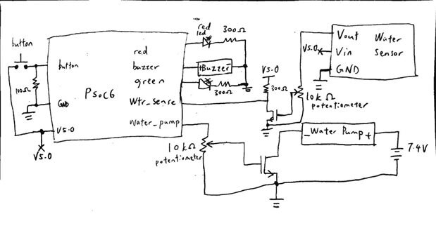

Few days ago, I have got some of the component that I have ordered online. With that, I'm going to make some improvements on my water dispenser that I have designed in my previous blogpost #8 Controlling water pump using PSoC6 .
I have replaced the 12 NPN transistor that I used in my previous blogpost with a N-channel MOSFET and also added a water sensor to the water dispenser to detect the water level.
BOM: PSoC6 WiFi-BT Prototyping Kit, a water pump, two 18650 battery, 18650 battery socket, 2 N-channel MOSFET, a push button, a buzzer, a red led, a green LED, 6x 10k ohm potentiometers, some jumper wires, a bread board, a water pump and hose, a 1.5L water bottle, a 500ml water bottle, bendable steel wire, a plastic tray, hot glue gun and glue sticks.

Schematic Diagram:

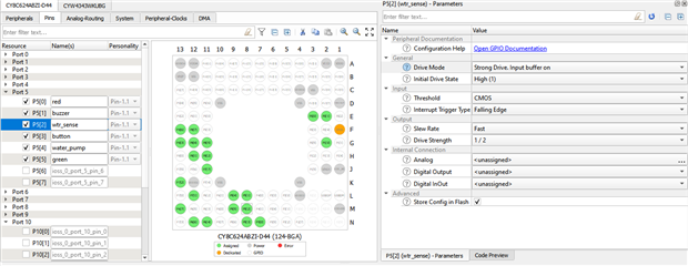

Device Configurator setting:
red               : strong drive input buffer off, Initial Drive State Low
buzzer         : strong drive input buffer off, Initial Drive State Low
wtr_sense   : strong drive input buffer on, Initial Drive State High
button         : strong drive input buffer on, Initial Drive State Low
water_pump: strong drive input buffer off, Initial Drive State Low
green          : strong drive input buffer off, Initial Drive State Low

Explanation of the circuit:
Water sensor calibration:
The high output for the red led and the buzzer can later on be modify to use to send the stopping signal to the water dispenser to stop it when the water level is high to prevent overflow.
