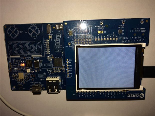

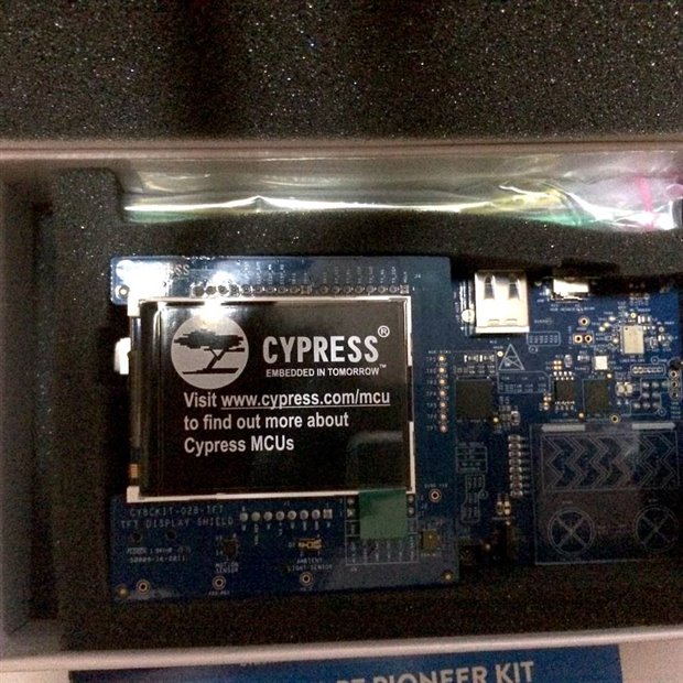

First Look of the  PSoC 6 WiFI-BT Pioneer Kit
Thanks for the element14 community term, Cypress and Amazon AWS. We received the pioneer kit and AWS credit moment ago.
The Cypress Pioneer Kit, which included some jumpers, a USB-C to A cable, the Quick start guides, the kits and the TFT which is pre-housed top of main kits.

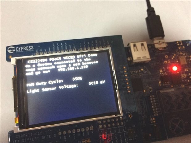

We follow the quick guides and sucess connect the device to our local Wifi network.

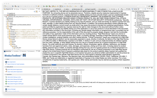

After that, I download the ModusToolbox 2.0 under cypress web-site, start the ModusToolbox 2.0 IDE, choose new application,
select kit CY8CKIT-062-WIFI-BT, select Next, choose "Hello World", Next and Finish.
The USB cable should connect to the KitProg3 USB ports for programming which is the Left USB port.
Build and Run, the RED LED flashing.
The next step is try to connect the device to AWS cloud services.
