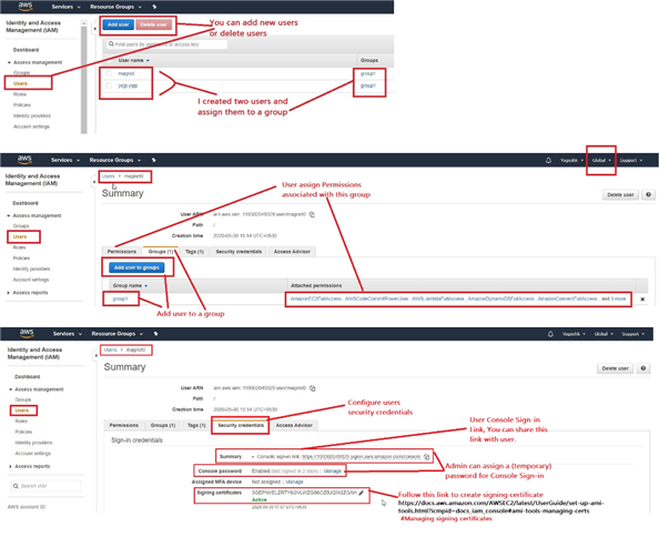

As the first step, we require to create a IAM User to delegate certain permissions later it would help us make programmatic request to AWS Cloud.
Root Access cannot (should not) be used to make programmatic access because its the root user and has complete access to your AWS Cloud.
Figure-1: IAM User
Best practice is to create an IAM User and allow restricted access to desired resources (services/policy) only.
for e.g.
AWSCodeCommitPowerUser
  • allow full access & permission for Code-Commit, i believe this is similar to GitHub
AmazonDynamoDBFullAccess
  • allow full access to database services (read, write, modify, etc)
AmazonConnectFullAccess
  • allows User access to Connect to AWS Cloud.
AmazonFreeRTOSFullAccess
  • allows your device to be able to connect and access AWS Cloud.
AWSIoTFullAccess
  • allow how your device operates with AWS Cloud.
AmazonMCSFullAccess
  • provide full access to Amazon Managed Apache Cassandra Service

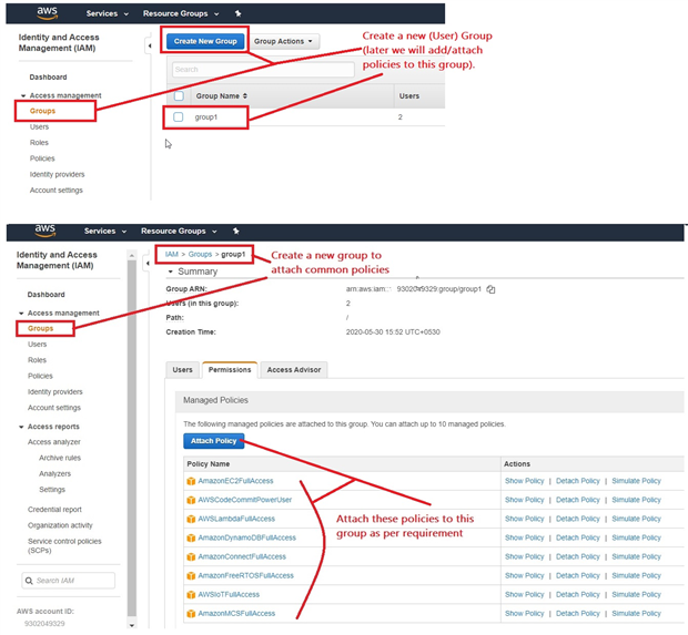

We can assign individual policies to the User or Create a common Group and assign this group to Users. In my case I have created a group named "group1" and assigned it to a user i created by this i would not have to add the required policies individually to a user, I have done this coz I'm in development stage and have kept it KISS - Keep it Simple Stupid.
Figure-2: User Group

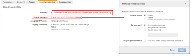

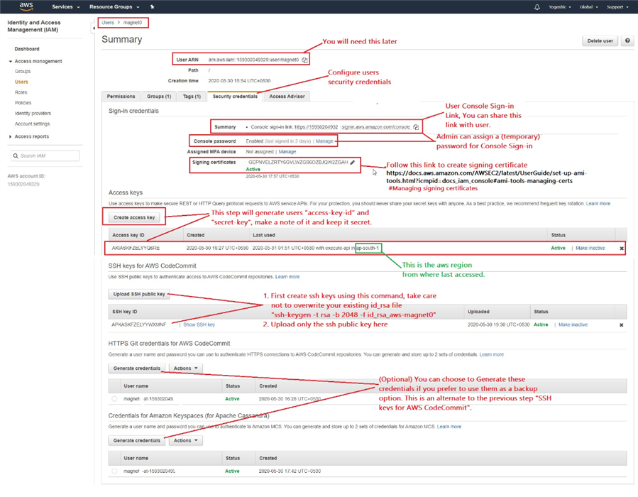

Setting up a User IAM account is important for use programmatic however before that we have to setup some credentials
a) Console sign-in setup
  • User can login from a web browser into his/her account.
  • Don't forget to create/assign a console password so user can login to his/her console.
Figure-3: Console Sign-in setup
b) (Optional) MFA
  • We'll ignore this for the moment.

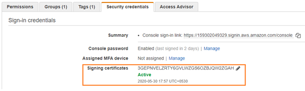

c) Signing Certificates
  • Certificate to authenticate this user.
Figure-4: Signing Certificate
  • To create a signing certificate
    • Install and configure OpenSSL.
    • Create a private key using the openssl genrsa command and save the output to a .pem file. We recommend that you create a 2048- or 4096-bit RSA key.
openssl genrsa 2048 > private-key.pem
    • Generate a certificate using the openssl req command.
openssl req -new -x509 -nodes -sha256 -days 365 -key private-key.pem -outform PEM -out certificate.pem
=>  Learn more about Signing Certificates

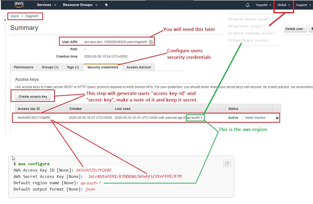

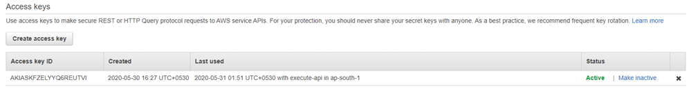

d) Access Keys
  • Allows Rest or Http protocol request to AWS Service APIs.
  • Use the IAM Dashboard's to "Create Access Key".
Figure-5: Access keys
=>  Learn more about Access Keys

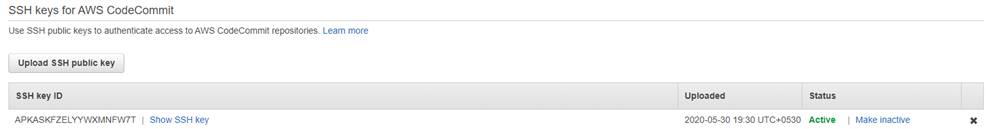

e) SSH keys for AWS CodeCommit
  • SSH public keys to authenticate access to AWS CodeCommit repositories
  • Use this command to generate "SSH keys for AWS CodeCommit", careful not to overwrite your existing .ssh/id_rsa file
ssh-keygen -t rsa -b 2048 -f id_rsa_aws-magnet0
Figure-6: SSH Keys for AWS CodeCommit
=>  Learn more SSH Keys for AWS CodeCommit

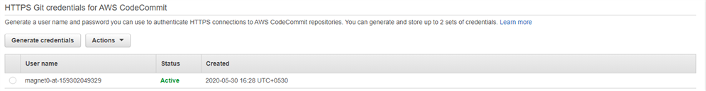

f) HTTPS Git credentials for AWS CodeCommit
  • Authenticate HTTPS connections to AWS CodeCommit repositories
  • Use the IAM Dashboard's to "Generate the Credentials" and make a note of the same as you will need it.
Figure-7: HTTP Git Credentials for AWS CodeCommit
=>  Learn more HTTPS GIT Credentials for AWS CodeCommit
IAM User Configure (consolidation)
Figure-8: IAM User Configure (a) to (f)

I will be highlighting below the required steps required to access AWS Cloud services via AWS CLI.
a) AWS CLI Installation
You can choose your installation from the link below, in my case its windows so I have downloaded "Installing the AWS CLI version 2 on Windows" and install it on my Desktop/Laptop. You can choose your installation here https://docs.aws.amazon.com/cli/latest/userguide/install-cliv2.html
b) AWS CLI Configure
This setup is to configure IAM User for access to AWS Cloud Services.
Learn more on how to configure AWS CLI

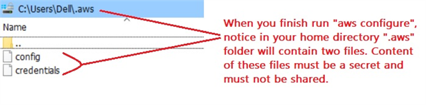

Refer to the "$ aws configure" command in the below picture. first half of this picture has already been investigated.
Figure-9: aws configure
When you have finish with "$ aws configure" command, You will notice a .aws folder in your home directory with two files in it. Keep them safe and do not share these files.
Figure-10: .aws config files

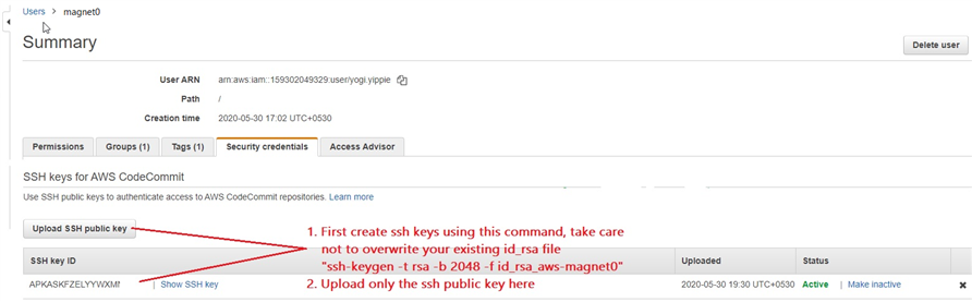

a) Create SSH keys
Use the below command to "Create SSH keys". This command will create two files (containing public & private keys), Copy them into your home ~/.ssh folder and take care not to overwrite your existing id_rsa files. Use the -f option to write to a custom file.
b) Upload SSH Public Key
Upload the "id_rsa_aws-magnet0.pub" content (not the file) into the "SSH keys for AWS CodeCommit" section of the users account.
Figure-11: Upload SSH public key

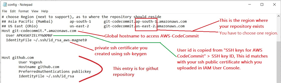

c) Git Configure to access AWS CodeCommit repository
If you are an expert, then you will be able to handle multiple ssh keys into your home ~/.ssh folder. In my case
for e.g.    ~/.ssh folder contains
id_rsa and id_rsa.pub = i use this for my github repository, Your ssh-config file should have this entry
id_rsa_aws-magnet0 and id_rsa_aws-magnet0.pub, I will use this to access my AWS CodeCommit repository
My ~/.ssh/ssh-config file content looks like this, contains 3 important fields
i) Host
ii) User
iii) IdentityFile
Figure-12: ssh-config file

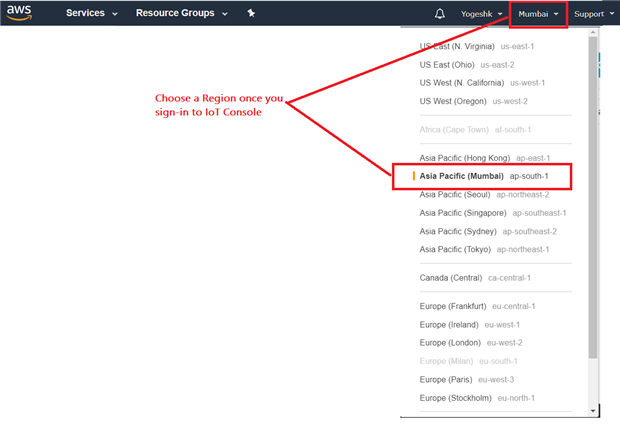

You can click on each section and follow the instruction in the given link. Keep in mind that when you are registering a device (as a thing) you should choose a region (location in the server where your device is registered). Choose the region closest to where you are located  (Live).
Figure-13: Choosing a Region in IoT Console

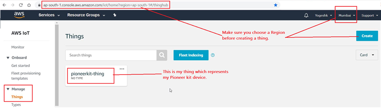

b) Create a thing

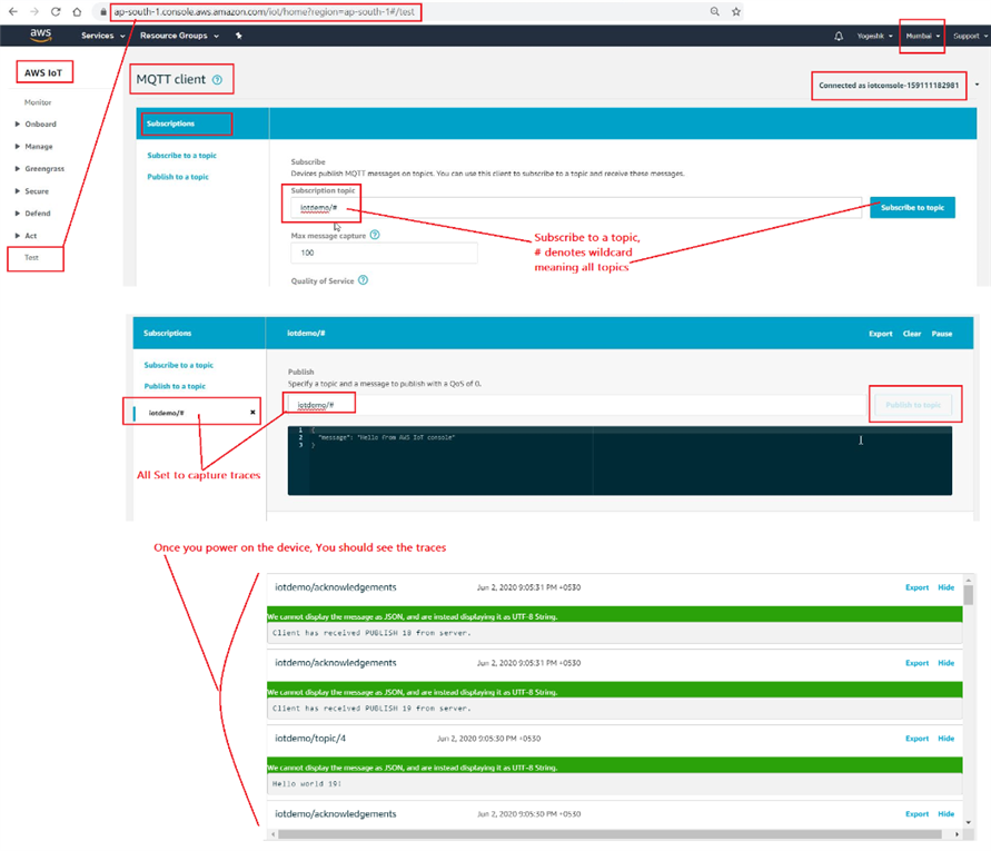

e) View device MQTT messages with the AWS IoT MQTT client

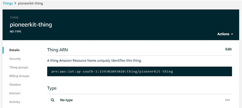

I have already done the above steps, so i will attach a few pictures
AWS IoT Console > Manage > Things
Figure-14: Thing
Figure-15: Thing (representing my Pioneer kit)

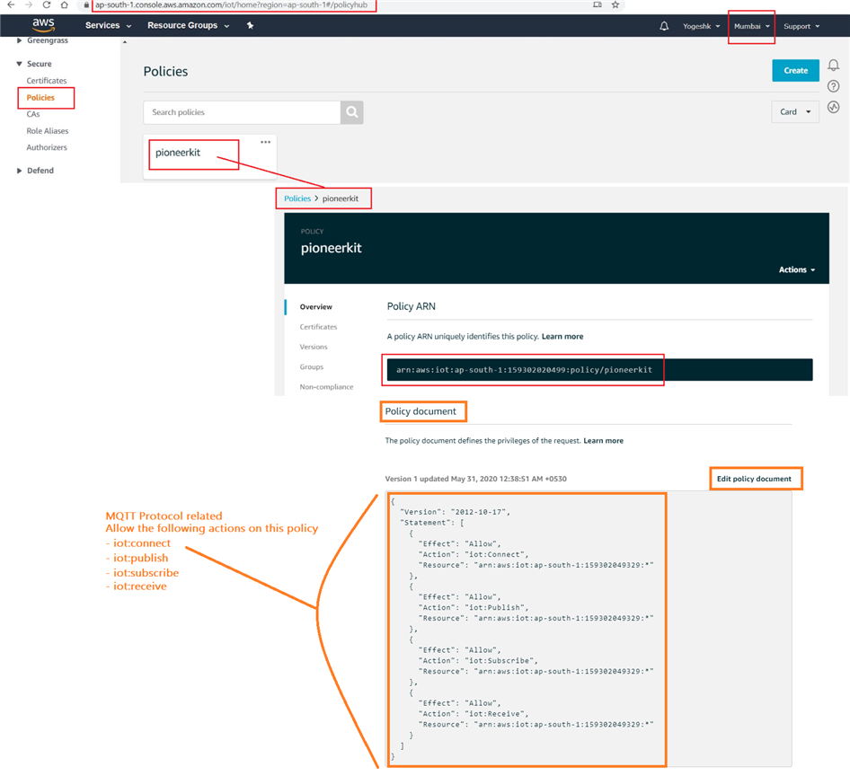

AWS IoT Console > Secure > Policies
Figure-16: Create Policies (which will allow secure connection to devices)

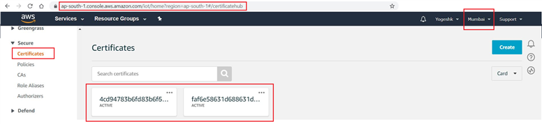

AWS IoT Console > Secure > Certificates
Figure-17: Certificates

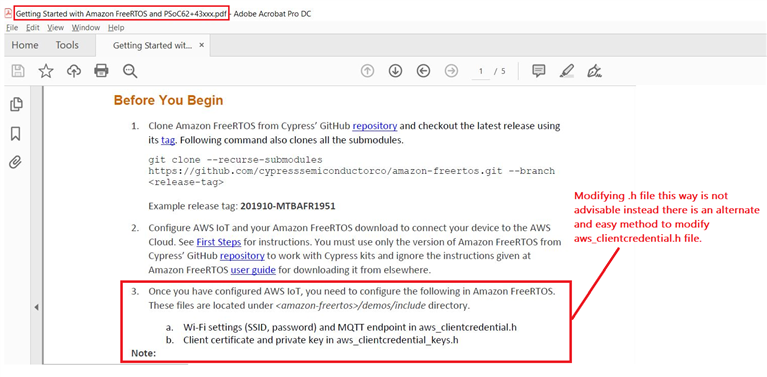

5. FreeRTOS (Console)
Click here for FreeRTOS (Console), This console link is useless since our Pioneer kit is not listed in Predefined configurations so you can ignore it.
Click here to Getting Started with Amazon FreeRTOS, - Suggest you to not refer to this link directly instead follow "Getting Started with Amazon FreeRTOS and PSoC62 + 43xxx.pdf"
Click here to Getting Started with Amazon FreeRTOS and PSoC62 + 43xxx.pdf, This document provides instructions for getting started with the following kits.
  • PSoC 6 Wi-Fi BT Prototyping Kit (CY8CPROTO-062-4343W)
  • PSoC 6 WiFi-BT Pioneer Kit (CY8CKIT-062-WIFI-BT)
Before You Begin (follow only this session from pdf "Getting Started with Amazon FreeRTOS and PSoC62 + 43xxx.pdf")
a. Click here for Pre-requisites  (follow these steps before you being with FreeRTOS)
b. Github repository: Clone Amazon FreeRTOS from Cypress
  • You can download this source code from Github and do not use any other FreeRTOS source code from elsewhere.
  • This Github source is specific to the following kit
https git clone command
git clone --recurse-submodules https://github.com/cypresssemiconductorco/amazon-freertos.git --branch 201910-MTBAFR1951
ssh git clone command
git clone --recurse-submodules git@github.com:cypresssemiconductorco/amazon-freertos.git --branch 201910-MTBAFR1951
follow these steps if you are not sure which branch (release) is the latest
git tag
201908-MTBAFR1941
201910-MTBAFR1951               (this is the latest at the time i am writing this blog)
git checkout 201910-MTBAFR1951

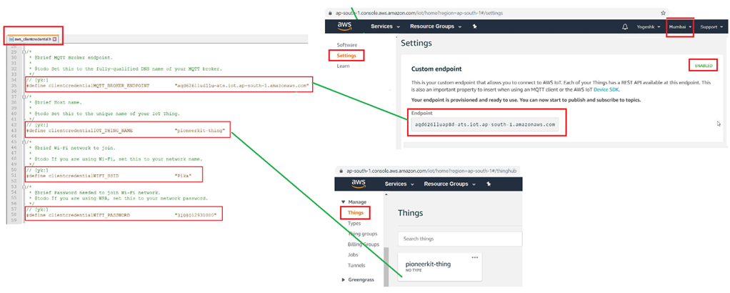

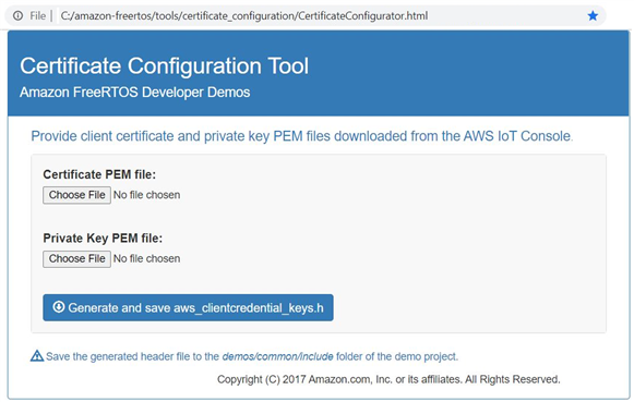

c) Wi-Fi settings (SSID, password) and MQTT endpoint in Source code amazon-freertos\demos\include\aws_clientcredential.h
Figure-18: Wifi Settings and Mqtt endpoint configure in FreeRTOS
instructions given in the pdf file suggest to manually edit the aws_clientcredential_key.h file
instead there is an alternate and easy way to edit aws_clientcredential_keys.h file.
Launch CertificateConfigurator.html open html file in IE or Chrome, This file is located in source code amazon-freertos/tools/certificate_configuration/CertificateConfigurator.html
Figure-19: aws_clientcredential_keys.h (modified).

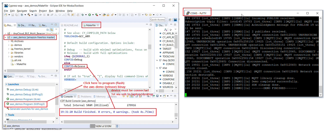

6. MQTT Demo App (FreeRTOS aws-demo)
  • Setting Up the Development Environment
  • Build and Run the Amazon FreeRTOS Demo Project

  • Monitoring MQTT Messages on the Cloud
I have successfully built aws-demo project using "ModusToolBox" and Flash the pioneer kit with the binary using the tool
Figure-20: aws-demo project build & flash using ModusToolBox tool
I will attach the putty logs of this demo app, refer to file "aws-demo-puttylog-mqtt.txt"
Figure-21: Test for MQTT
