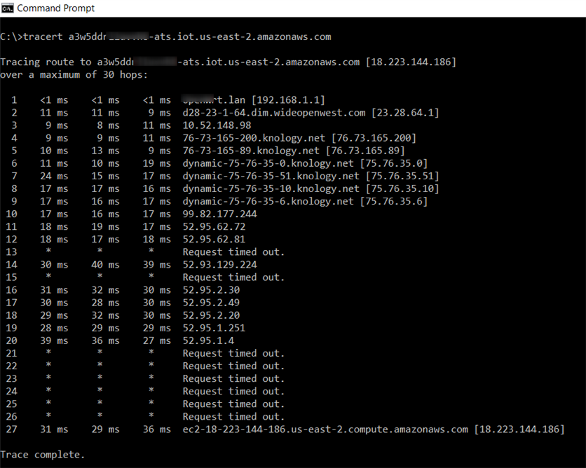

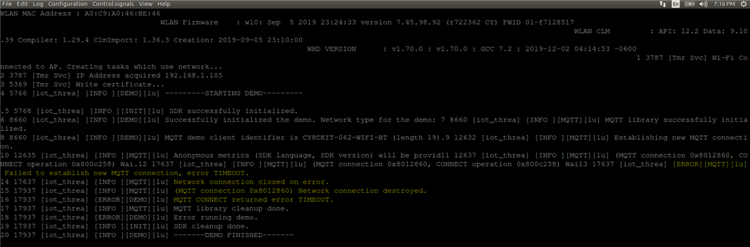

Problem to Connect Kit to Cloud
I followed the start guide Getting Started with Amazon FreeRTOS and PSoC62 + 43xxx and downloaded the demo from Cypress' Github repository, then built the project and programed the kit. Unfortunately, my kit failed to establish MQTT connection as shown in the screenshot below.
Here's the text version of the log shown above in the screenshot.

I posted my question on Cypress' forum (https://community.cypress.com/thread/53437 ) and hope someone can help me solve the problem soon. If you know the solution, please post in the commenting area. I really appreciate your help.
Update: I found the issue after reading saicheong's  Mbed connect to AWS iOT, OS, driver, security ..  #2. My problem was, in the policy file, I replaced ":<region>:" with ":<us-east-2>:" which should be "us-east-2" (i.e., remove <>). After updating my policy, the kit is successfully connected to the cloud. The serial console output is:

Update: I have to switch my region from us-east-2 to us-east-1 because us-east-2 doesn't support sending SMS and/or phone app notification push operations. I think in US, only two regions support both of them: us-east-1 and us-west-2.
  • clem57
    clem57 over 6 years ago +3
    Please verify that you have a valid connection to the cloud on your wifi. A tracerout can help.
  • vlasov01
    vlasov01 over 6 years ago +3
    I had the same issue, I've spent a lot of time trying to solve this issue... You need to check if your device certificate has been activated.
  • cmelement14
    cmelement14 over 6 years ago +3
    Found the issue after reading saicheong 's Mbed connect to AWS iOT, OS, driver, security .. #2 . My problem was, in the policy file, I replaced ":<region>:" with ":<us-east-2>:" which should be "us-east…
  • clem57
  • cmelement14
    cmelement14 over 6 years ago in reply to clem57
    Clem,
    Thanks for your reply. I tried traceroute and it took very long time and 27 hops to make the connection. Probably that was the reason why the MQTT connection failed. Do you have any solution for this problem? Thanks again for your help.
    Charles
  • cmelement14
    Clem,
    Charles
  • cmelement14
    cmelement14 over 6 years ago in reply to cmelement14
    Let me try if I can change the source code to keep trying until it succeeds.
  • clem57
    clem57 over 6 years ago in reply to cmelement14
    Try to change fro AWS east to AWS west maybe...
  • cmelement14
    I thought the region was assigned to my account automatically and I couldn't change it. Let me try it.
