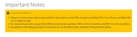

MBED can use online an offline IDE. A good documentation is here https://os.mbed.com/teams/Cypress/
i am tyring with the PSoC 6 WiFi-BT Pioneer Kit, hence i go further to https://os.mbed.com/platforms/CY8CKIT-062-WiFi-BT/

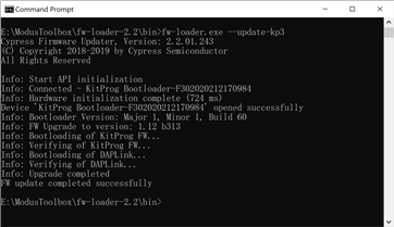

i find that i can't transition to DAPLink following the guide mode upon connect to PC, so i need follow the instruction "NOTE: if you cannot transition to DAPLink mode using CY8CPROTO-062-4343W, then get Firmware-loader 2.2.01 or newer, which fixes that problem." on https://github.com/cypresssemiconductorco/Firmware-loader
however, even after i update the firmware i still face problem. It is similar to what's discussed on forum https://community.cypress.com/thread/48874?start=0&tstart=0

    i did manage to solve mine, by upgrading the firmware driver to the correct version.
