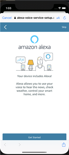

Alexa for IOS
Firstly, i wish build prototype by use the Cypress Pioneer Kit connect to AWS Alexa, we builded a Companion IOS App and try the step of LWA.
The problem is the Cypress Pioneer Kit only with 288kb SRAM, as the heap size is too restricted, although most communication though MQTT,
the access token update require another TLS socket for https connect, which every TLS socket require relative high heap size, our MQTT open one Socket, and we require additional memory for sound buffering and shadow, the WHD wifi also require so many resource. As our experiments, build the new https TLS socket will let all network down, require reboot for recovery.
The Prototyping Kit have 1MB SRAM should get better result working for Alexa IoT project.

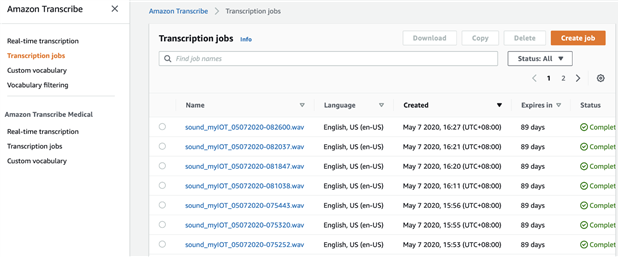

Transcribe Job
            transcribe = boto3.client('transcribe')
            job_name = key.replace("income/","")
            job_uri = "https://voicerecognise.s3-us-west-2.amazonaws.com/income/"+job_name
            transcribe.start_transcription_job(
                TranscriptionJobName=job_name,
                Media={'MediaFileUri': job_uri},
                MediaFormat='wav',
                LanguageCode='en-US'
            while True:
                status = transcribe.get_transcription_job(TranscriptionJobName=job_name)
                if status['TranscriptionJob']['TranscriptionJobStatus'] in ['COMPLETED', 'FAILED']:
                    break
                print("Not ready yet...")
                time.sleep(5)

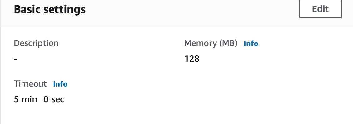

Simple we pass the internal S3 sound file uri to Transcribe and wait for job done, because the transcribe sometime require few minutes to finish, set Lambda Function Timeout to 5 mins.

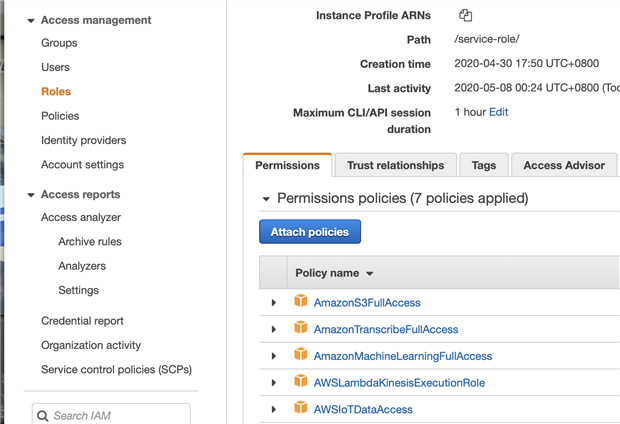

Send Result to IoT
First, set the Permissions:
Permissions > Execution role > click the "Role" > IAM > added AWSIoTDataAccess
The return json not include the transcript, instead we open another Uri for the Transcript

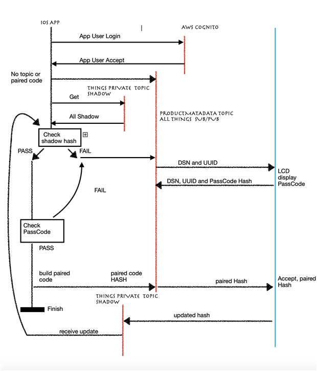

The IOS App Pairing

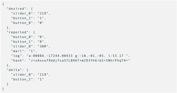

Our APP use AWS IoT Shadow for sync between IOS App and the devices for two-way control, although user identify by Cognito, the last version of IOS App only support one devices "Things". Finally in this project, we improve the APP to support many "Things". We suppose every Device with a unique "Things" under AWS IoT, our job for ensure the App user is real the owner of the mailbox, the pairing step is:
1. APP User enter the DSN (device serial no) which every products with a unique number under firmware or write to eFuse
2. The LCD display a passcode
3. The APP User input the passcode in the APP
4. Finish, unless another IOS APP pair this device or change of IOS account, the user don't require pairing again.
The "Things" name is transparent to users, so it is more security and flexible can be change in future.
All above process only need a shared MQTT publish/subscribe channel and a addition shadow states "HASH", no server required.

1. We retrieve the pairing_passcodekey and passcode storage under User Preferences, if not find, no paired.
2. If IOS Preferences with pairing_passcodekey and passcode data , we work for "get" the "Things" shadows, if no "hash" shadow, no paired.
     if the "hash" observed, we calculate SHA256 pairing_passcodekey hash, if both hash some, pass.

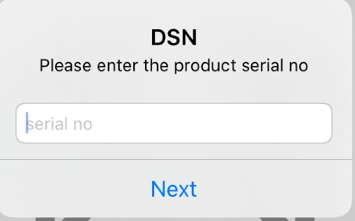

Implement Pairing
For new user, or the passcode HASH check fail, the user need work for pairing, to link the products and the APP.
1. Firstly a dialog require the customer enter the Product Serial No
2. The App subscribe to "mailbox/productmetadata/get", publish a message  to "mailbox/productmetadata", which every "mailbox" subscribe this.
/* subscribe for listen get device productmetadata */
    dataManager.subscribe(toTopic: "mailbox/productmetadata/get", qoS: .messageDeliveryAttemptedAtLeastOnce, messageCallback:messageblock )
    dsn = input_dsn;
    /* send publish to get device productmetadata */
    dataManager.publishString("{\"requests\":\"ios_pairing\",\"dsn\":\"\(dsn!)\",\"uuid\":\"\(uuid!)\"}",onTopic: "mailbox/productmetadata", qoS: .messageDeliveryAttemptedAtLeastOnce )
requests: ios_pairing
dsn:      The serial code
uuid:      The APP UUID (A unique ID for IOS APP)

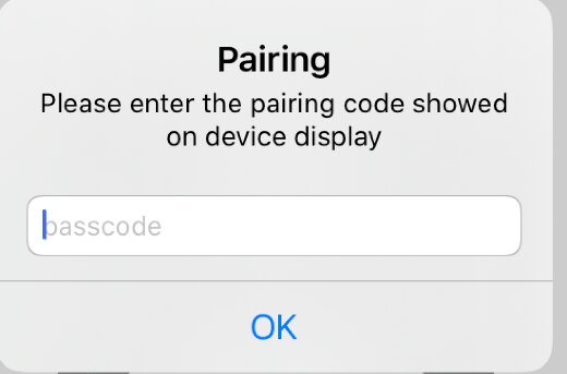

3. Devices random choose 8 character codeverifier  and display on LCD
mbedtls_ctr_drbg_random((void*)&ctx_drbg,(unsigned char *)codeverifier,8);
   for(int i=0;i<8;i++){
   if (codeverifier[i]>='A' && codeverifier[i]<='Z')
   continue;
   if (codeverifier[i]>='a' && codeverifier[i]<='z')
     continue;
   if (codeverifier[i]>='0' && codeverifier[i]<='9')
     continue;
  codeverifier[i] += 23;
  --i;
Devices calculate the SHA256 hash of codeverifier  and send those information to APP
sprintf(productmetadata,"{\"DSN\":\"%s\",\"TOPIC\":\"%s\",\"HASH\":\"%s\",\"UUID\":\"%s\"}",DSN,AWSIOT_THING_NAME,base64buffer,uuid.c_str());
  awsiot_publish(productmetadata,"mailbox/productmetadata/get");
DSN:      The serial code
UUID:      The APP UUID
HASH:     the code verifier HASH
TOPIC:    device things name
4. APP received above code, check the DSN and UUID match, and show the dialog require user enter the 8 character showed on LCD
5. APP check both HASH, if some mean the user input correct.
    The APP generated 32 bytes random paired_passcode and send the paired_passcode's HASH to Device
   dataManager.publishString("{\"requests\":\"ios_paired\",\"dsn\":\"\(dsn!)\",\"uuid\":\"\(uuid!)\",
\"pass_hash\":\"\(passhash)\"}",onTopic: "mailbox/productmetadata", qoS: .messageDeliveryAttemptedAtLeastOnce )
6. The Device received above message, simple update the HASH to shadow and save the HASH to FRAM for power loss retrieve.
  status.pass_hash = passhash;
  fram_write_status();
  awsiot_update("hash", passhash);
All above hash encode with BASE64.
