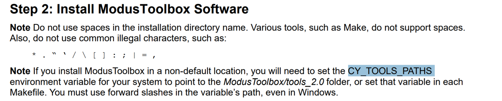

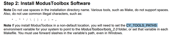

i did encounter a problem when it complains CY_TOOLS_PATHS is not set, and i resolve it by adding environment variable as describe in  https://www.cypress.com/file/492936/download image

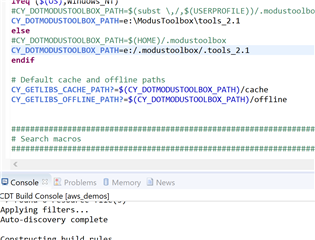

the more annoying error is that once you set the CY_TOOLS_PATHS, the CY_DOTMODUSTOOLBOX_PATH in start.mk file is invalid
my settings below is simply ignored.
the summary is need more settings work if install in non default location

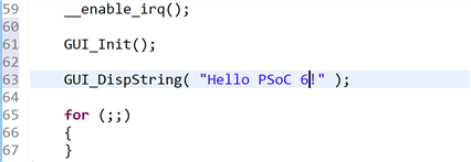

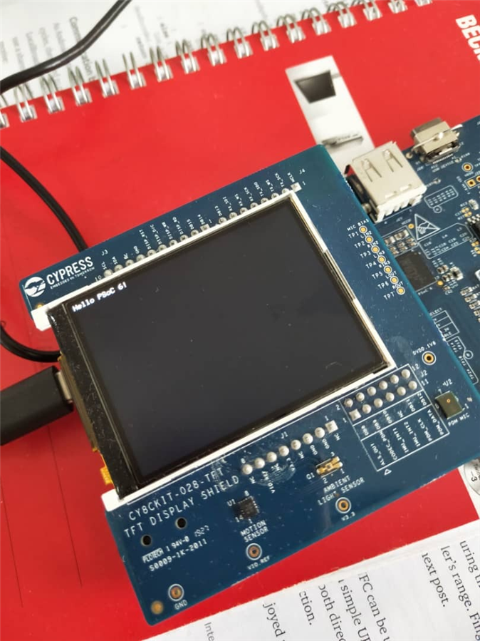

back to the TFT support

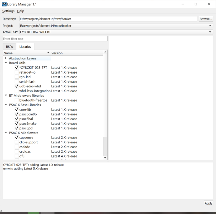

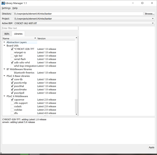

create new project and add the emwin and TFT in library
choose COMPONENTS=EMWIN_NOSNTS
put in the #include "GUI.h"
and add these lines before the forever loop

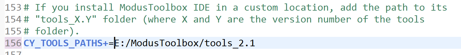

then i get an error again, due to path. Modus Toolbox is really non forgiving when it comes to non default installation path
ERROR: The backend failed to start. The current executing tool is expected to be run from a sub-directory of 'tools_#.#'. The tools folder was not found above the currently executing path:
E:/ModusToolbox/Tools_2.1/cfg-backend-cli
The most likely cause is a corrupt install. Either reinstall the tools or specify a custom path on the command line.
make: *** [libs/psoc6make/make/core/config.mk:161: libs/TARGET_CY8CKIT-062-WIFI-BT/COMPONENT_BSP_DESIGN_MODUS/GeneratedSource/cycfg.timestamp] Error 1
"e:/ModusToolbox/Tools_2.1/modus-shell/bin/make CY_MAKE_IDE=eclipse CY_IDE_TOOLS_DIR=e:/ModusToolbox/Tools_2.1 -j12 all" terminated with exit code 2. Build might be incomplete.
i need to do below at the makefile
