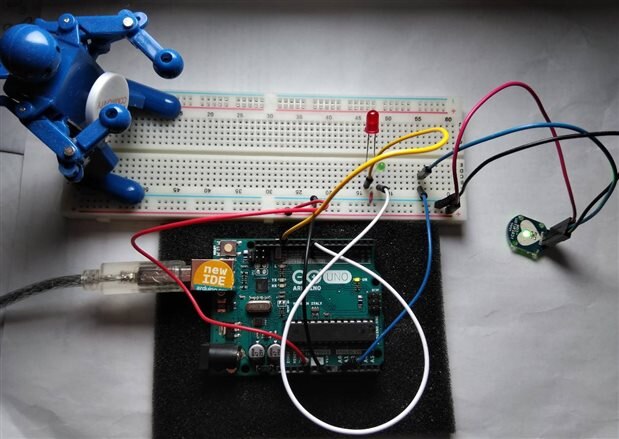

I never used it before. But it comes with some Arduino sample. I've decided to test if it is working before connecting to Cypress board. I've soldered three pins to the sensor board and connected it to my Arduino Uno. I've connected power to ground and 5V and analogue output to A0.
I've download the sample of pulse sensor code from the manufacturer of the sensor http://www.icstation.com/product_document/Download/3554.zip
The bundle has two programs. One is for Arduino to read analogue sensor readings and covert them to serial output as numbers. The second program reads serial output from Arduino and draws graph on PC as well provides heartbeat measurement as BPM. I've used a free open source tool OBS Studio to capture the process of programming Arduino Uno, getting serial data and getting visual representation on video.

Now it is clear that sensor is working as expected I need to learn how I can program Cypress PSOC to use it ADC to read signal analogue from the sensor.

    Hi Sergey, it is a good decision to use dedicated HRV sensor, instead of getting bpm values from AD8232(intended for ECG measurement), which happens to produce noisy signals and interference with the A…
    genebren over 6 years ago +1
    The sensor is working quite nicely. The light detected pulse is really a nice way to the heartrate.
  • vlasov01
    vlasov01 over 6 years ago in reply to genebren +1
    I completely agree with you on this point.
  • vlasov01
  • vlasov01
    vlasov01 over 6 years ago in reply to ankur608
    Hi Amkur,
    Thank you for your feedback! My intention was to measure ECG and get BPM as byproduct of ECG.
    But I agree, that it is much simpler to work with optical sensor than with AD8232. And it is cheaper to operate as it doesn't require single use ECG electrodes.
  • ankur608
    ankur608 over 6 years ago
    Hi Sergey, it is a good decision to use dedicated HRV sensor, instead of getting bpm values from AD8232(intended for ECG measurement), which happens to produce noisy signals and interference with the A.C., along with a set of electrodes that need to be placed wisely on the subject's body.
