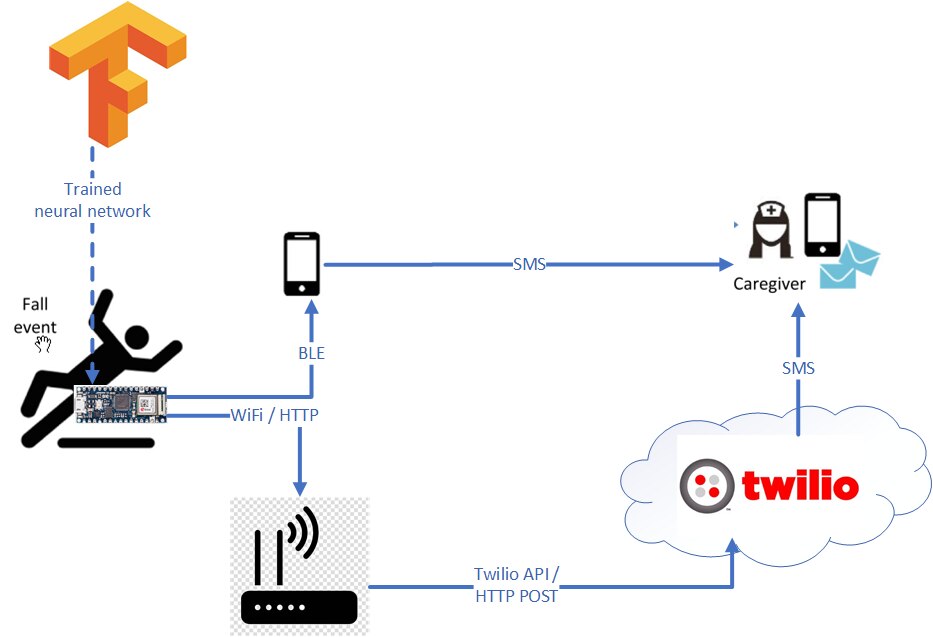

Project components
The wearable device will have the following features
  • based on Arduino Nano 33 IoT
  • fall detection algorithm will be implemented using a neural network. To feed the neural network with accurate data, a sliding-window peak-detection algorithm will be implemented
  • connection with the home WiFi network, to send notifications when a fall event occurs when at home
  • connection with a smartphone, to leverage an app to route notifications to the rescuers in case of a fall event happening away from home
The technologies that will be used for this project are
  • TensorFlow, to model and optimize the neural network that detects fall events
  • Bluetooth Low Energy, to connect wearable to a smartphone
  • Twilio REST API, to send SMS to the caregiver using the home WiFi network
Project plan
This project involves the following steps
  • Building the wearable device
  • Modelling, training and tuning the neural network that will classify accelerometer readings as "activity of day life" or "fall"
  • Sensing the world (collect accelerometer reading and provide data to the trained neural network)
  • Implementing alarm notifications through smartphone app and Twilio REST API
