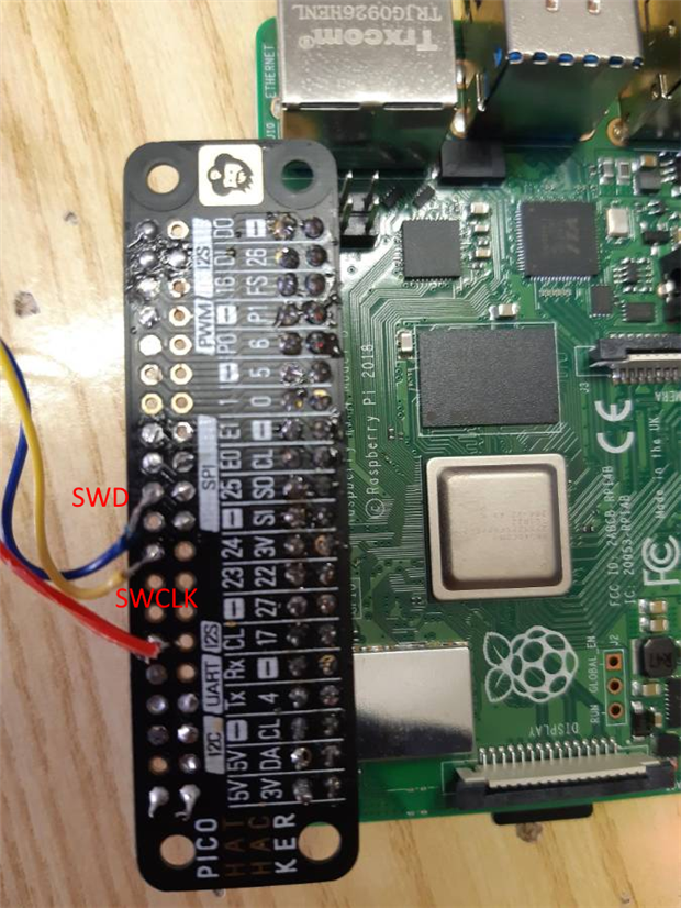

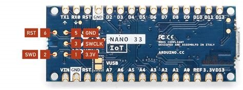

Prepare the hardware
You need to connect only two wires: SWD (pin 2) and SWCLK (pin3)
I connected SWCLK to GPIO 25 of the Raspberry Pi and SWD to GPIO 24 (see picture below). Blu wire is connected to SWD, the yellow wire to SWCLK. The red wire is the reset, but looks like it is not strictly required
I powered up the Arduino board using a USB cable connected to Raspberry Pi so that extra ground wiring is not required

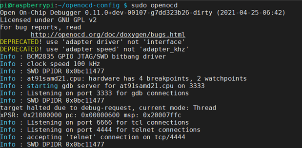

Launch openOCD
In a shell window, run the command
     cd ~/openocd-config
     sudo openocd

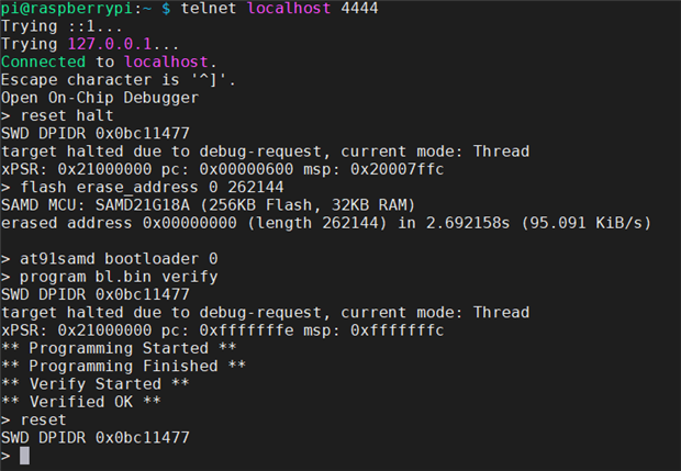

Install and launch Telnet
  • install Telnet (this tool is not available by default on Raspberry Pi)
          apt-get install telnet
  • launch telnet
     telnet localhost 4444
Erase flash and install bootloader
  • from the telnet prompt, enter the following commands
     reset halt
     flash erase 0 262144
     at91samd bootloader 0
     program bl.bin verify
     reset
     run
