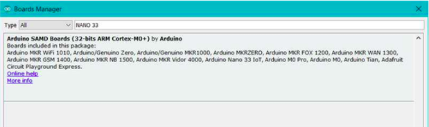

First after getting the board , I have set up the Arduino IDE by installing Board
From Tools menu -> Boards -> Boards Manager
Then Tried out example blink code and they worked correctly

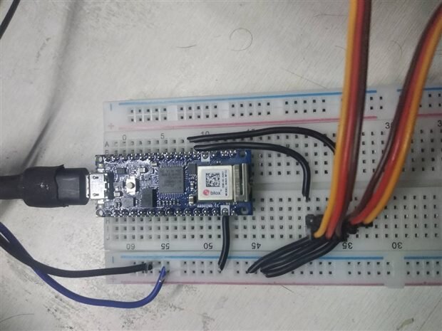

For Controlling the Servos , they needed +5V Supply but Arduino Nano IoT only has 3.3V Supply, So I used external Power Supply

Testing:  Testing Video of Servo At all Position
