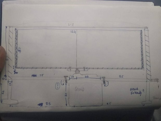

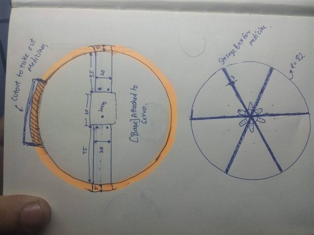

Initial Design Idea
This was my initial paper design to make a circular rotating storage with door such that it moves to the position angle and then opens the door, using total of 2 servo motors.

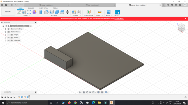

CAD Models:

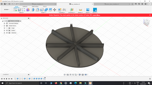

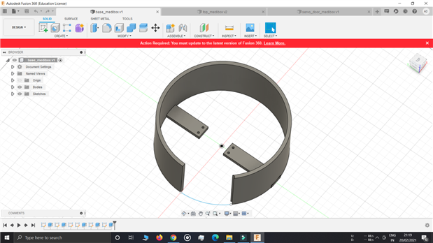

All the cad design were created  using Fusion 360 ,using refrence of above design. CAD Files Download

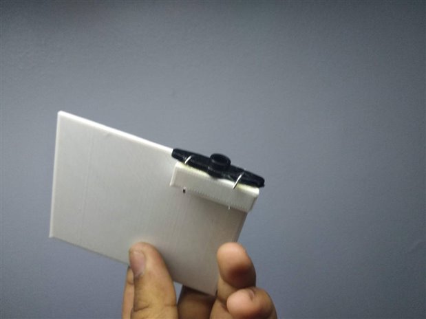

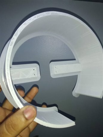

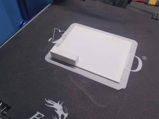

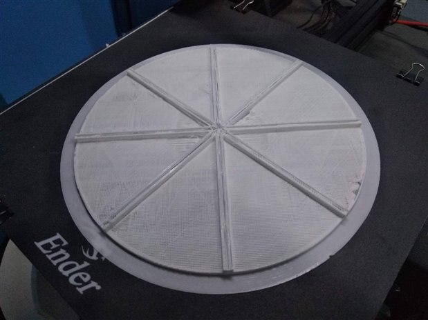

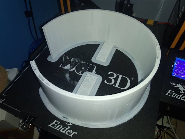

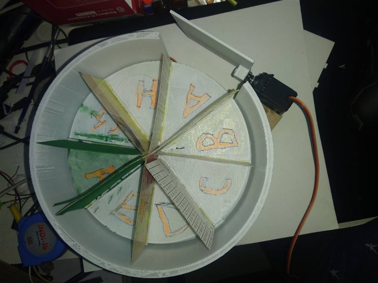

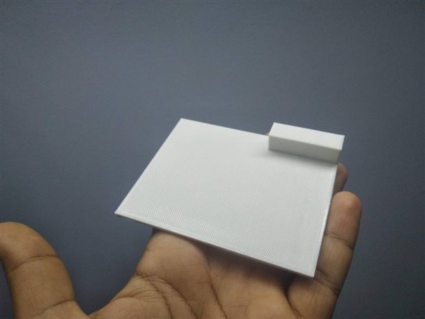

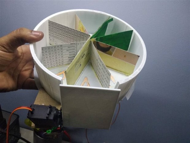

3D Prints:
These Parts were printed on Ender 3 at 10% Infill with PLA and Layer Height of 0.2mm.

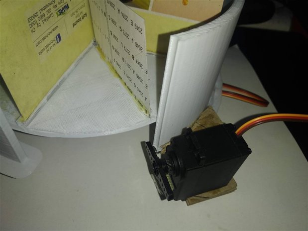

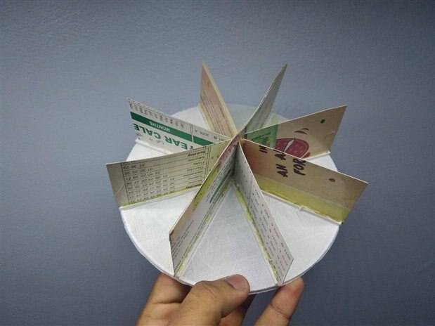

Here we have used cardboard pieces to divide between boxes due to some problem with the printer in printing thin walls

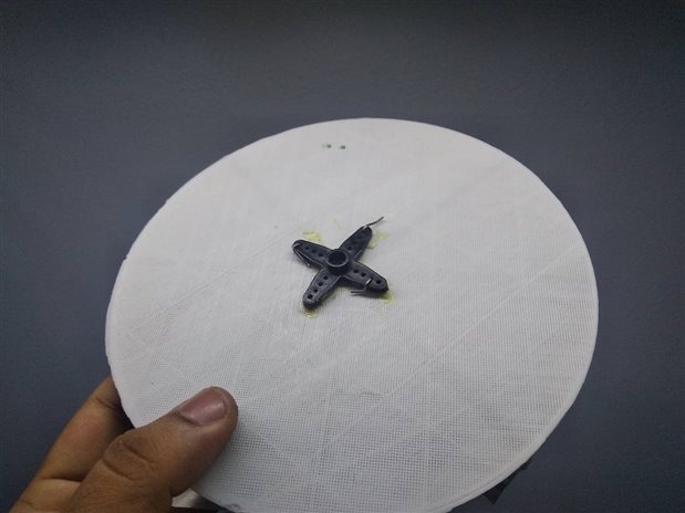

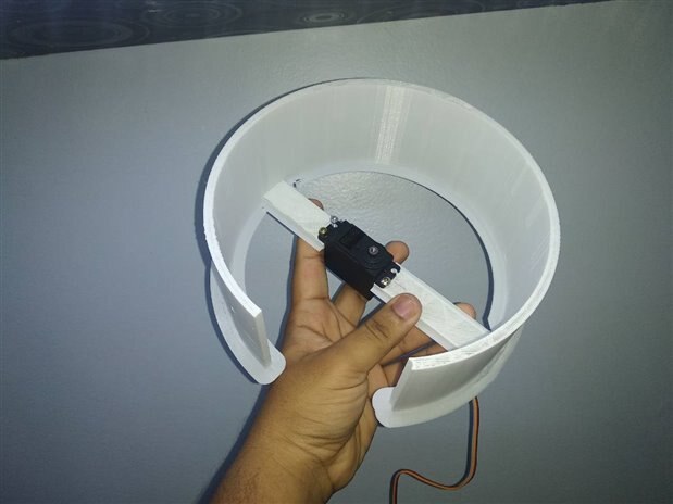

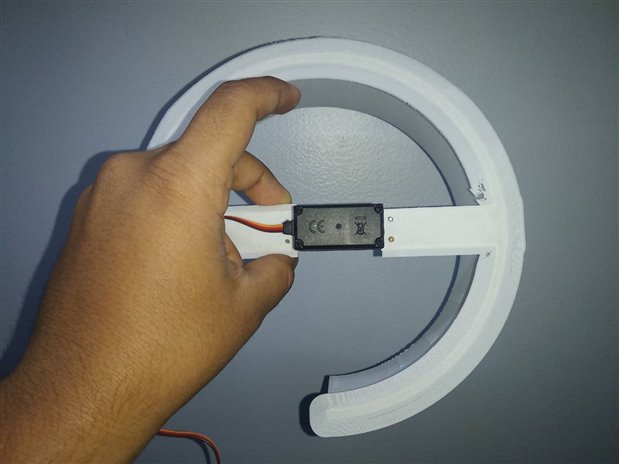

Attaching Base Rotating Servo Motor:

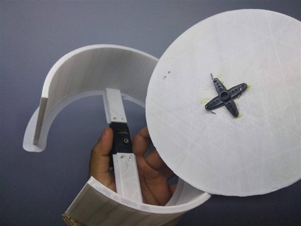

I have added screw holes to CAD  so any generic servo motor can fit in with some screws.
Use the Servo Head and stick it to the Top Rotating  Part

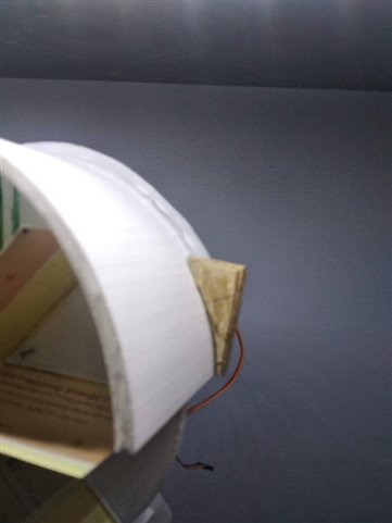

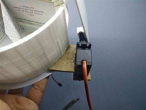

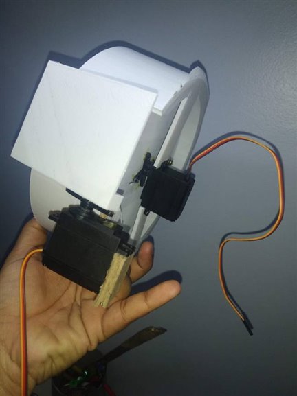

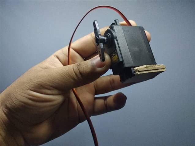

Adding Servo Door MountFor the servo door I have used Cardboard pieces to attach the servo door motor to main structure
Final Assembly:
