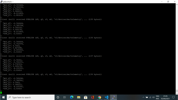

Arduino Nano 33 IoT is advanced Arduino dev kit designed for IoT implementation. It has a network module such as WiFi and BLE, allowing us to send the data to Arduino cloud over MQTT and HTTP by using internet connectivity. This project is to aim to how we could integrate LSM6DS3 (accelerometer and gyroscope) module sensor embedded on Arduino nano 33 IoT, so this dev kit is very easy to do an experiment.  We will implement it to connect with the cloud. so then data sent to cloud, accelerometer, and gyroscope data will be visualized on the web dashboard.
MQTT is an OASIS standard messaging protocol for the Internet of Things (IoT). It is designed as an extremely lightweight publish/subscribe messaging transport that is ideal for connecting remote devices with a small code footprint and minimal network bandwidth. MQTT today is used in a wide variety of industries, such as automotive, manufacturing, telecommunications, oil and gas, etc.  https://mqtt.org/
You can copy this source code for running arduino nano 33 IoT

    serializeJsonPretty(doc, payload);
    mqtt.publish(publishTopic, payload);
    Serial.println(payload);
