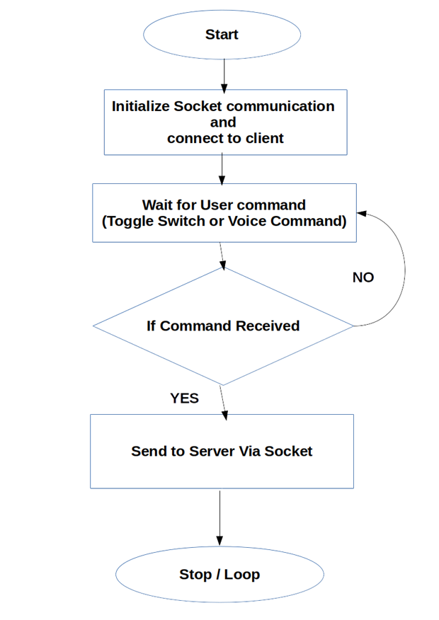

Algorithm
               The algorithm chart given below is simple explanation of our Python code.
