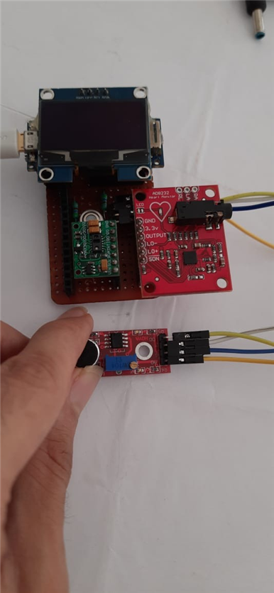

Lastly, since my country is facing the worst of this second wave of the corona virus, I am unable to get more sensors or materials for an indefinite time period. Even getting PCBs developed is difficult given the current circumstances. Hence, I have decided to make changes to my BuzzBeat v1.0 GP board. I will also try to measure RR and RRV using an analog microphone. But since it might be a bit inconvenient to place the mic such that it can measure breathing noises, I have considered 2 possibilities - attaching an analog mic to my gp board so that a person can breathe onto it or use a mobile phone to capture audio samples for analysis via our mobile app, whichever is more convenient and gives better performance.

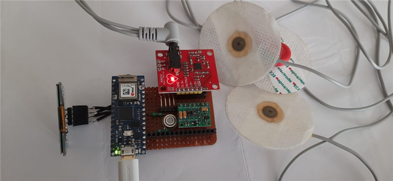

First, I modified the gp board I used for Buzzbeat v1.0 to incorporate the MLX90614, ECG AD8232 module, OLED 1.3" display, MAX30100 sensor and the Nano 33 IOT. The images are as attached below -
So as you can see, there is the ECG sensor, MAX30100 sensor, MLX90614 sensor, etc. connected to my board. There are also a few headers that are used to connect other things like the mic for audio samples and future expansion.

Also, Using DSP on an arduino to calculate RR and RRV from breathing sounds taken by the mic was not a good way. So what I did was this - I pushed all the instantaneously changing values like IR PPG signals, Red light PPG Signals, audio signals and ecg signals via serial or local wifi to an app or software so that the computer or mobile phone could analyze the signals and handle tougher math. So I would send the following data to the app -

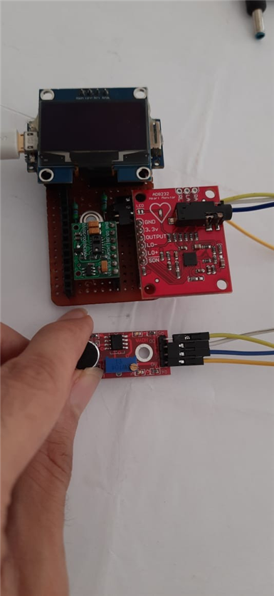

  • A mic module for capturing breathing noise
We will be using it as mentioned in the code below:
We will be using CSV format to parse data via WiFi to our app. The code has been attached. Analog Outputs of ecg and mics have been connected to A7 and A6 of Arduino Nano 33 IOT respectively. The remaining pins used are A5 and A4 which are SCL and SDA respectively, 5V, 3V3 and GND. Some optional pins that you can use are digital pins for setting the mic threshold to detect a particular amplitude of sound, or to detect whether or not the leads of ECG sensor are attached or not.

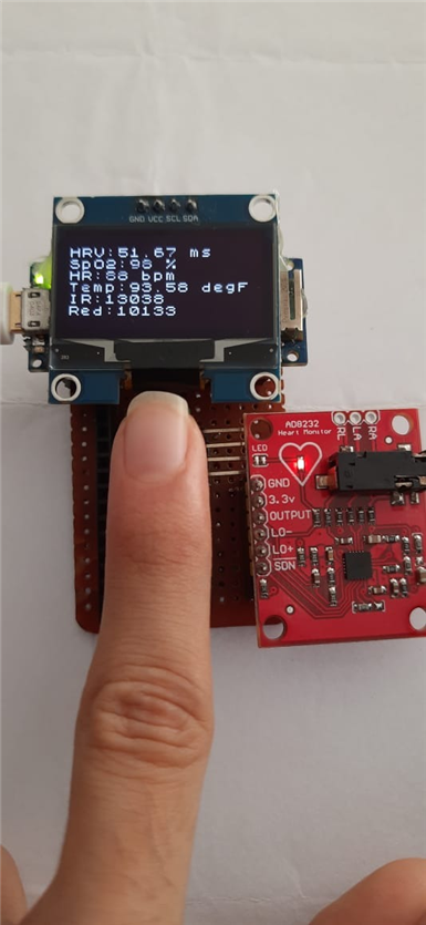

This is the demonstration of what the above code and hardware do. The parameters are pretty accurately measured and the prototype looks much better than I expected. I tested and compared the results with a standard oximeter and they matched perfectly! Also, the MLX90614 sensor shows a bit lower temperature reading than it should as it measures the temperature of fingers. We can add the offset between the oral and peripheral temperatures to compensate for this error. The display values are updated every 10 seconds, you can easily change that by editing the above code.
