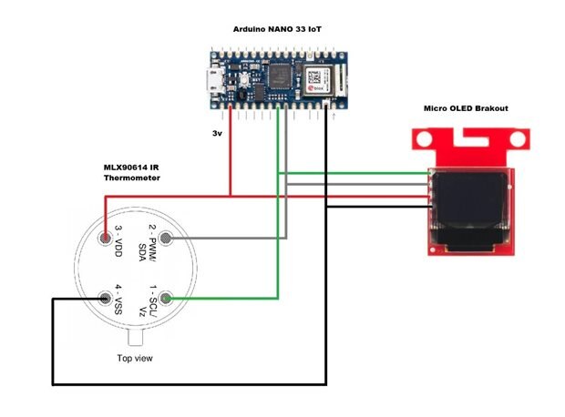

INFRARED THERMOMETER WITH UBIDOTS, PART 1
HARDWARE
In the image below I show you the electrical diagram that we will use in this chapter.
LIST OF PARTS:
  • Arduino Nano 33 IoT Development Board
  • Infrared Thermometer - MLX90614
  • Micro OLED Breakout
  • Lithium Ion Battery - 1Ah
HOW DOES IT WORK?
  • First, the WiFi connection is established between the Arduino NANO 33 IoT board and the Modem;
  • The infrared thermometer detects two temperatures: 1) the ambient temperature, and 2) the temperature of the aimed object;
  • Both temperature values (ambient and object) are printed on the serial port and the Micro OLED Breakout screen for 5 seconds approx ;
  • Every 5 seconds the object temperature value is sent to the IoT server.
  • We will use the service provider IoT Ubidots, and the configuration will be seen in the next chapter.

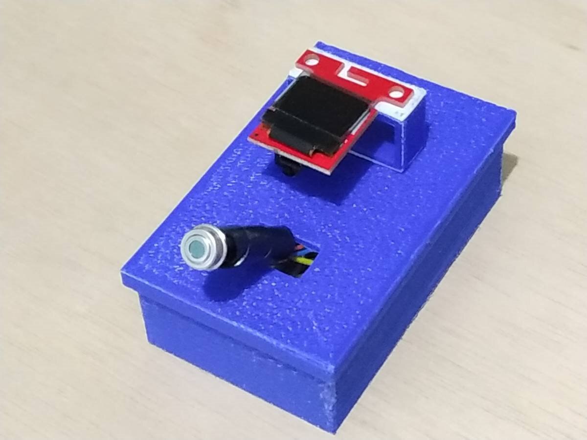

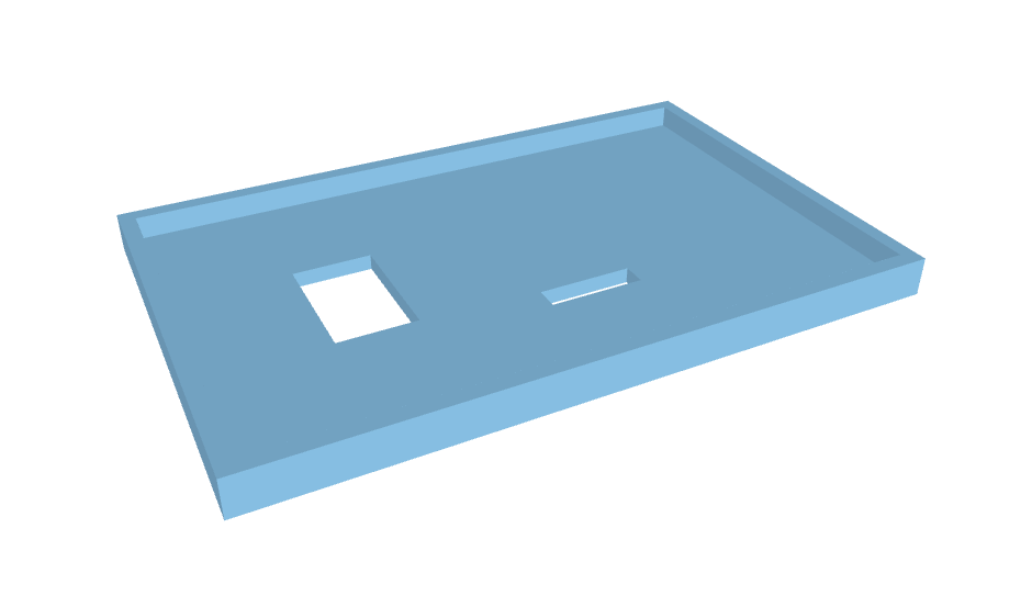

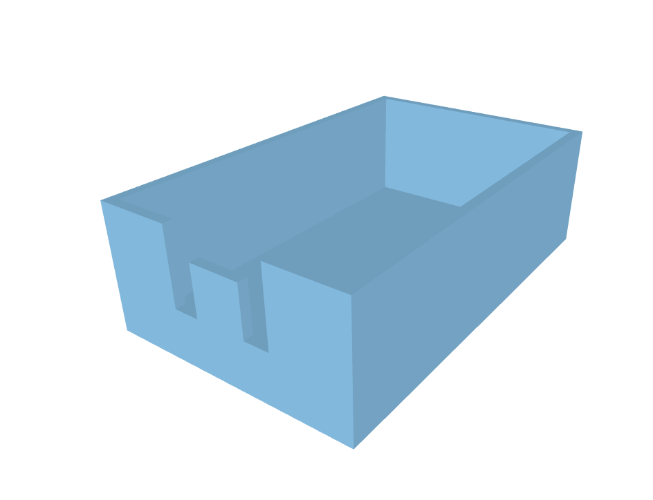

3D PRINTING AND ASSEMBLING THE DEVICE
In the image below we show the box designed for this device.
Also, the image below shows the cover.
If you want to make a 3D impression of these designs, you can download the STL files here:  health_monitoring_box.rar
The image below shows the assembled project.
