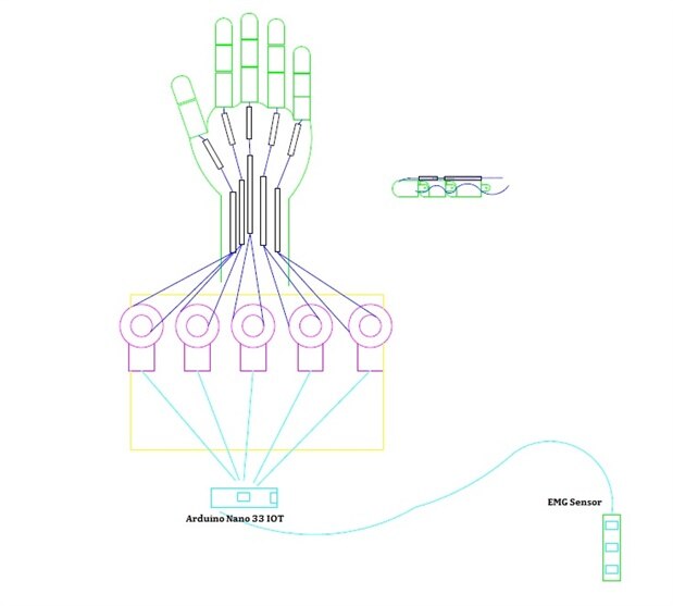

Sensor:
The sensor is quite impressive!! The EMG sensor (electromyography sensor) measures small electrical signals generated by your muscles when you move them. EMG sensors and systems are used extensively in the fields of ergonomics, sports science and medical research.
The EMG sensor electrode pads are placed in the innervation zone of both tendons for better detection quality. The electrodes detect the electrical activity of the muscle which is amplified by the INA828 microchip. This signal is then sent to the Arduino to figure which finger to move. By setting parameters of the signal strength makes it easy to decide which servo to activate. I found that the location of the electrodes greatly changes the signal strength. Once I got the location pin pointed, each finger movement had specific signal strengths.
Example:
We’ll use the base signal of no muscle movement as 0.
The following are the signal strength of each finger:
     Small Finger: 200 - 300
     Ring Finger: 300 - 500
     Middle Finger: 900 +
     Index Finger: 700 - 900
     Thumb: 500 - 800
With this information I programmed the Arduino for finger movement.

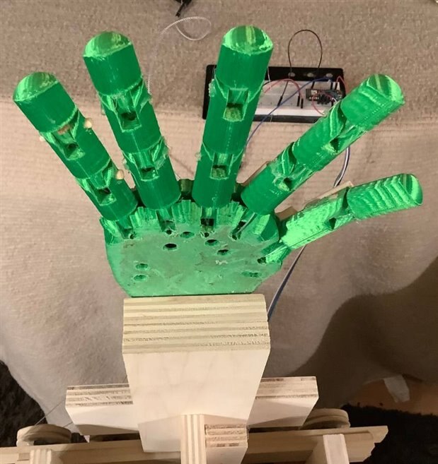

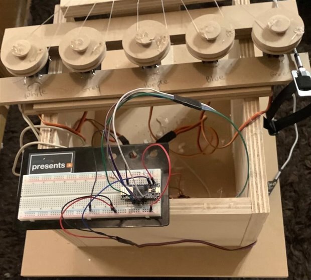

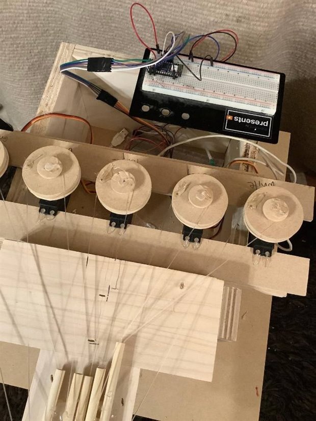

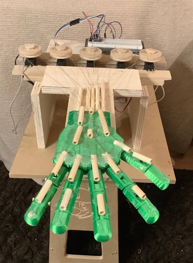

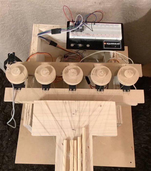

Photos:
Below are photos of the finished robotic hand!!
