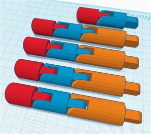

My proposal for "Design for a Cause" is to make a muscle controlled robotic hand. I know this isn't an original idea, but my goal is to make it affordable. I will be using the Arduino Nano 33 IOT Board along with a sensor board I will be making. I will 3d print the robotic parts along with using servos to create an inexpensive muscle controlled robotic hand. When complete, hopefully it will make this robotic hand affordable to anyone in need.

Below is the 3d printer picture of the fingers I designed

    dwinhold over 5 years ago in reply to dubbie +3
    Hi dubbie , I have made a wooden finger prototype to make sure my idea would work. I basically made the jointed wooden finger with strings and elastics to act like the tendons which will be controlled…

    javagoza over 5 years ago +3
    Dale, very interesting, I'm looking forward to seeing that hand in action. From what I understand you are trying to control a three-fingered hand. Is that? Many problems to solve, a re you going to train…

    dwinhold over 5 years ago in reply to javagoza +3
    Hi Enrique, I am actually going to make a full hand with all fingers. I will have the machine learn which signal is for which finger with a starting calibration run. Noise reducing will have to be integrated…
    Many problems to solve, are you going to train a machine learning model to classify the signals captured by your sensor?
    Have you thought about how to reduce noise to have a better signal quality?
    It is a really challenging project! Congratulations!
    Hi dubbie,
    I have made a wooden finger prototype to make sure my idea would work. I basically made the jointed wooden finger with strings and elastics to act like the tendons which will be controlled by the servos. I will be uploading a video of how it works shortly. I didn’t want to start printing out the parts to find out it didn’t work. I will also upload the 3D printing files for others to use.

    dubbie over 5 years ago
    Dale,
    Nice 3D printed fingers. Some more details would be interesting.
