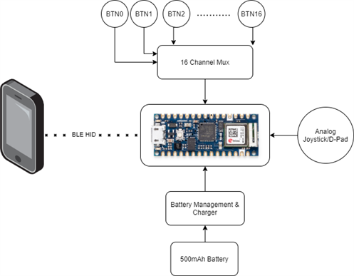

image Usage of Arduino Nano 33 IOT:
The main use case around what Arduino Nano IOT is its small size, low power consumption and its ability to function as a BLE HID interface which is key for the keypad to operate without the requirement of any driver or app on the smartphone.
Hardware Block Diagram:
