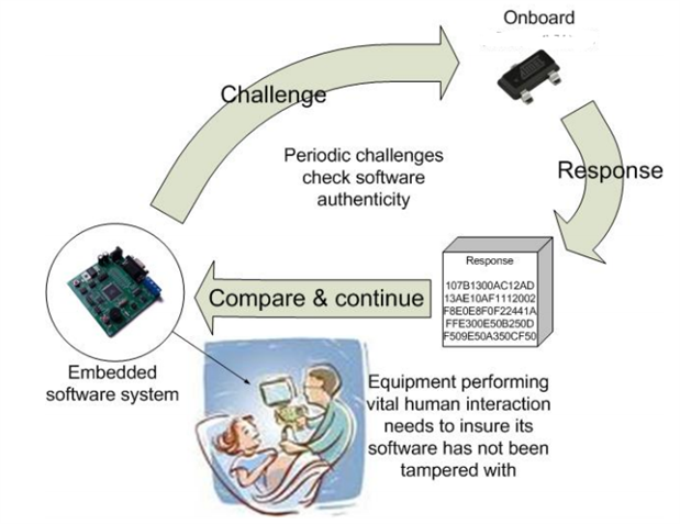

When connecting to AWS IoT Core using MQTT, devices are required to use X.509 certificates with TLS for authentication, as AWS IoT Core does not support authentication via username and password like many other MQTT broker services provide support for. Microchip ATECC608A crypto element can be used to securely generate and store a 256-bit ECC (Elliptic Curve Cryptography) key. 256-bit ECC keys have an equivalent strength to 3072-bit RSA keys (more information can be found here).
Figure below shows anti-clone as example, Challenge-Response Cycle is how the ECC608A works. Refer to http://ww1.microchip.com/downloads/en/Appnotes/doc8663.pdf for other similar applications.

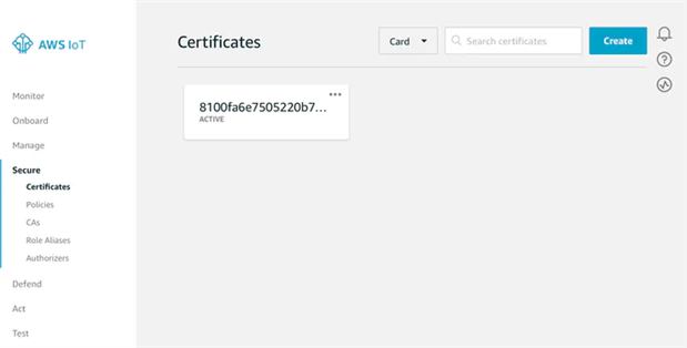

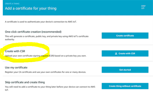

The CSR generated by this sketch is set in slot 0 of ECC608A, the value shall be copied to txt file and upload to AWS
make it valid in AWS IoT Core
Basic knowldge on cipher and decipher is required before download this binary file into Nano 33 IoT. The extra effort is needed in complex - dangerous cyberNet. Even Tesla was hacked in a Hack Show remotely without touch anypart of the Car, starting the engine just outside the cabine. The bug is fixed, and hacker team swips off so-called 1-million bonus. But who knows what is next bug.
4 Application in AWS IoT
This is one example on AWS IoT wifi with secret data below, CSR sall be same as what uploaded to AWS IoT core,
