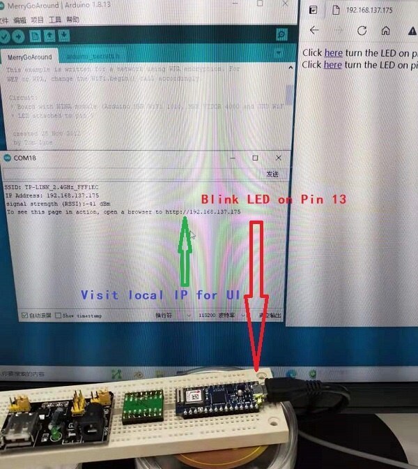

1 Introduction
There have been several remote control choice for Nano 33 IoT, like MQTT, AWS IoT things. But the quick choice is using wifi library to make it work.
Make simple http server running on board. Control or read data from Nano 33 IoT would be much easier.
2 The http server
Http server is complex. But simple http server only parse raw strings, detect what in this connection from HTML head as "Content-type:text/html". The body of html would be sent to http client and resolved accordingly. Use brower like Edge or Chrome as quick connect solution.
For large file like voice or image, UDP transmission can work within 256 byte fairly well. I have tried with voice sampling, but the time-splice could not be controlled precisely, the voice is distorted. I have to put away this idea for the moment.
Voice control from mobile phone, then send the control command directly.
3 Control LED
The onboard control use "digitalwrite"
Send commmand with HTTP GET command , that is not enscripted. So, use this choice only in safe network.

as in
With gif
5 Summary
This is remote control part, right motor control shall be used for this go around to Play.
