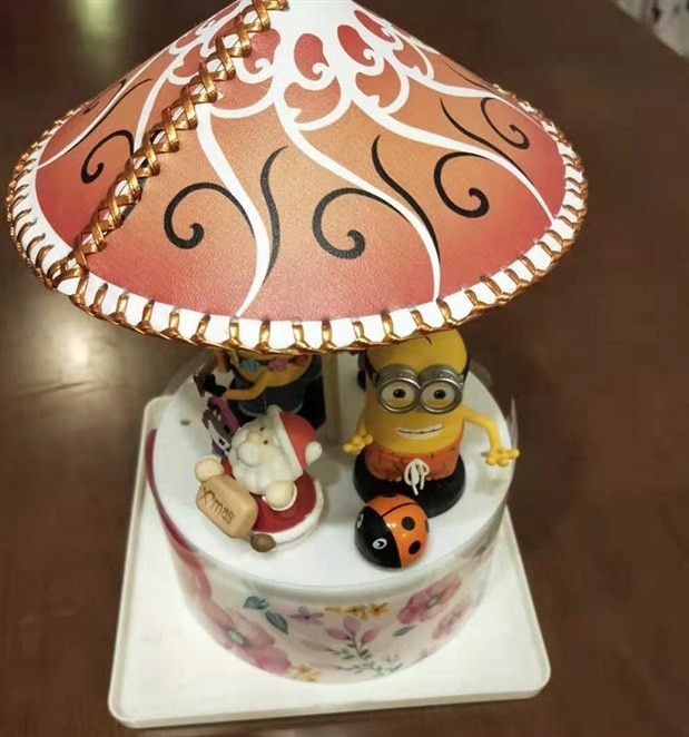

1 The Build of Merry-Go-Around
Make the support frame and decorated with favorite avatar, the plate can turn with DC motor.
