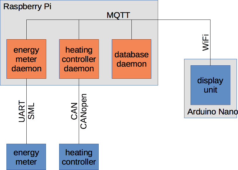

My project will read the information of the energy meter and the heating controller, store it, compute it and send it to a display unit. The main controller will be a Raspberry Pi and will be powered by the grid.
energy meter
Recent energy meters are solid state types and have an optical infra-red interface. This will be connected to the serial port of the Raspberry Pi and interpreted. The SML protocol is used on this interface.
heating controller
My heating controller has a CAN bus and uses the CANopen protocol. It will be directly connected to the Raspberry Pi using my CANFDZeroHAT - CAN FD controller for the Raspberry Pi
Display Unit
The display unit will use the Arduino Nano 33 IoT and will be powered by a rechargeable battery. In this use case this is the most efficient power supply because a grid power supply would have more standby losses than the system overall needs. It will use an 2.9 inch e-paper display which consumes no power when displaying static content. It will wake up from time to time controlled by the internal timer and get the current data from the Raspberry Pi via WiFi. Additionally it will be possible to wake the Arduino by tapping on it. I want to use the tap detection of the builtin accelerometer for this function.

I plan to use MQTT to transmit the data and conect all parts of the project together. The Raspberry Pi will be the MQTT Broker and hold all the data. The heating controller deamon will also run on the Raspberry Pi and publish its data. The energy meter deamon will do the same. A third deamon, the database deamon, will collect the data from heating and energy meter and store it to a database and calculate historical data and savings. The Arduino will subscribe to that data and publish it. As the Arduino will stay mostly in sleep state it won't get live data but request the data from the broker each time it wakes up.
system overview
This block diagram schows all the parts of the system
