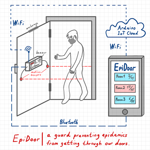

The main aim of the 'EpiDoor' device is to count, control and report the number of people going in and out of a particular indoor location, e.g. a shop, a lecture room, or a cinema hall. Several 'EpiDoor' devices will be connected into a network via WiFi allowing an administration of a local organisation to monitor the situation via a phone in real-time. Such automation will make the process of following official policies from health organisations a more effective tool to prevent the spreading of epidemics in the field.The conception of the 'EpiDoor' device is illustrated bellow.

Two ultrasonic or IR sensors are used for counting the number of people coming in and out. A ten segment LED bar shows the occupancy rate, while a buzzer will be activated when there are more people than allowed. In addition, the notification will be sent via Bluetooth or WiFi from Arduino Nano IoT to a mobile phone. All the components and Arduino will be connected through a breadboard, supplied by 5V power-source, and packed into an enclosure.
