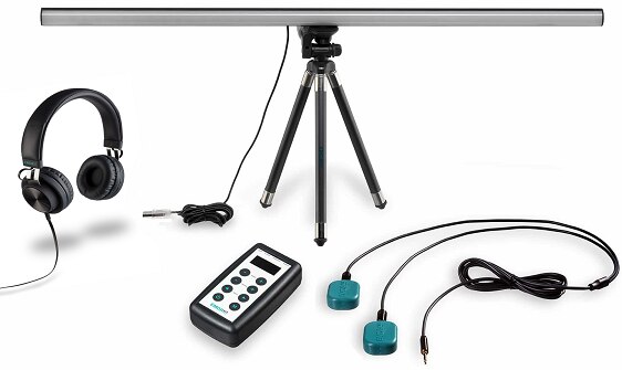

The commercial EMDR machine consists of tappers, headset, controller and light bar.
It has three main modes, that can be also combined together.
  1. Light mode. Light on the light bar is moving back and forth, and a client is following it with their eyes.
  2. Vibration mode. Client is holding tappers (small vibrating pieces) and they vibrate in a cycle, one after another.
  3. Sound mode. Client has a headset on, connected to controller. Sound in the headset cycle from the left ear to the right ear, and back.
When modes are combined, they are synchronized. All cycles repeat with the same speed. I.e. When light on the light bar in the most right position, client hears sound in the right speaker, and the right tapper vibrates.

    Tappers are just waterproof vibration motors. Client holds them in his hands and they turn on in sequence. When one is on, another is off, and vice versa. Repetition and constant shifting of attention from one hand to another is supposed to calm people and to help them to process a psychological trauma. For the brain it works the same way as repetitive shifting of sound and/or light. The type of the machine I am going to make will let therapist to use all three sensory inputs together and it should be much more effective than just light. I did a small EMDR machine before with just tappers. I used rotating motors with a toothbrush heads glued on them, so they kind of rub client's palm. It was not a good solution - motors will just stop rotating if client clinches his fists hard enough.
    And in addition to hands' tappers I am going to add another set of tappers - more powerful 12V motors to be connected to client's chest. I will just put them in the pockets of a special t-shirt. The same idea: Both sets will be synchronized with each other and sound and light. I assume two sets of tappers will be more powerful that one.
