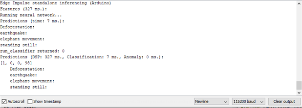

Results from the model detecting the standing still motion with 98% accuracy.
