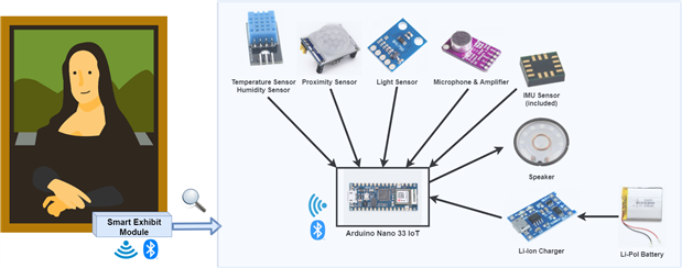

Hello!
Based on the ideas of my project, Smart Exhibit, and the capabilities of the Arduino Nano 33 IoT board, I decided to use the following additional components:
  • Temperature, humidity, proximity, light and IMU sensors - Used for collecting information about the environment where the exhibit is placed
  • A microphone module and a speaker - Used by the visitors for asking questions and getting answers back (will be used together with AWS Alexa Voice Service)
  • A power supply based on a battery and a charger for it - Used for providing the necessary energy for the device to run without being connected permanently to a wired power source.
The choices for each of these additional hardware components, some useful observations and the connection way to the Arduino board are shown in the table below.
ComponentTypeObservationsConnection with Arduino Nano 33 IoT
Temperature SensorDHT11Together with the Humidity Sensor in the same moduleDigital input
Humidity Sensor(see above)(see above)(see above)
Proximity SensorHC-SR501-Digital input
Light SensorBH1750
The light intensity provided value is in Lux
(some other light sensors which I was considering were providing a proportional value with the light intensity but not the actual value in Lux)
I2C connection
IMU SensorLSM6DS3Included in the Arduino Nano 33 IoT boardI2C connection
Speaker0.25W, 8Ohm-Digital output (with PWM)
MicrophoneMAX9814 CMA-4544PF-WMicrophone and MAX9814 AmplifierAnalogue input
Battery chargerTP4056Li-Ion battery charger module with battery protectionVIN and GND
BatteryLiPo 3.7V 1500 mAh
I already ordered these components, so I am looking forward to testing them and to playing with them together with the Arduino Nano 33 IoT board image
