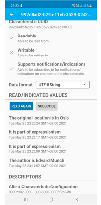

    • When a visitor connects via BLE to the exhibit using an app like LightBlue, different facts are sent every 10 seconds using a readable characteristic.
      • This is how the provided facts look like. Every 10 seconds a new fact is available. As it can be seen, even if the Read button is pressed multiple times within the same 10 seconds interval, the same fact will be provided.

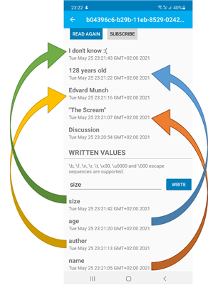

    • Using a different characteristic, questions can be asked to the exhibit by the visitors. If the questions are one of the standard ones, to which the exhibit "knows" how to answer image, then a reply will be provided. Otherwise, the exhibit will let the visitor know that it doesn't know the answer.
      • This is how the discussion with the painting "The Scream" by Edvard Munch can look like image. Questions are asked in a short form (in the bottom part) (e.g. name, author, age) and the answers are provided (in the top part).
      • image
