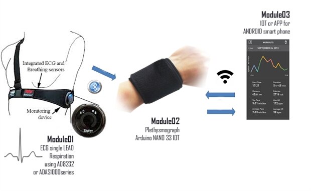

System model
Module 01 image
AD8232 will be used for single lead ECG data acquisition.
Impedance measuring topology can be used for respiration rate detection. However, respiration can be detected by the R-R period from ECG signal too.
Another way could be use of ADAS1000 series AFEs for both ECG and respiration all together.
I have both AD8232 and ADAS1000 in my hand which I got from ELEMENT14 for another design challenge. I have used the AD8232 for the 'sudden impact design challenge' and posted several blogs on that earlier.
The monitoring device will send data to module 2 through BLE.
Module 02imageimage
Photoplethysmograph signal will be taken using MAX30102 for oxygen saturation in blood.
A temperature sensor will be used to measure body temperature simultaneously.  MAX30102 has on chip temperature sensor, which can be calibrated and used for this purpose.
Arduino NANO 33 IOT will capture the data and process it. It will also receive the data from module 1.
It will communicate with the cloud platform using the wifi. In the absence of the IOT, it can send data to a smart phone app to store the body parameters. The App will push the data into the cloud when it gets online.
NANO 33 IOT comes with an onboard 6 axis IMU [LSM6DS3] which can be used for detecting rapid movement. The PPG signals from MAX30102 can be distorted and SPO2 calculations may give errors due to this rapid movement. The IMU chip can be useful to get rid of this kind of motion artifact.
Module 03
A smart phone android app can be used to monitor and store offline data. The cloud platform will be used to store data online, which can be examined by the doctor later on.
