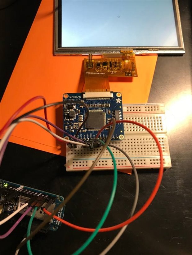

I received the Adafruit 5.0" 40-pin TFT Display 800x480 with Touchscreen PRODUCT ID: 1596 and the RA8875 Driver Board for 40-pin TFT Touch Displays 800 x 480 Max PRODUCT ID: 1590.
I had a hard time getting the display to work with the MKR1000 device so I checked the Adafruit website but no luck on the wiring diagrams or instructions.
I tried the Arduino website and no one had any information on how to wire it up. I tried Google and YouTube for any wiring videos.
I connected my Uno to the RA8875 module and put the jumper wires to the ports listed in the Arduino ino file for the ts_calibration and the TFT display lit up and I was able to get the touch readings!
So with doing that, I tried the MKR2UNO module and wired it as I did with my Uno and it didn't work.
Not be defeated, I looked at the MKR2UNO schematics and compared Pin to Pin with how I had it connected to the Uno and tried some different pins, modified the ino code for the ts_calibration under the Adafruit RA8875 library that I added to Arduino and it worked!
Here are the RA8875 pins and the MKR1000 pins that need to be used for the calibration.
RA8875/ MKR1000
VIN/ PIN 14 = +5
GND/ PIN 11 = GND
SCK/ PIN 09 = SCK
MISO/ PIN 10 = MISO
MOSI/ PIN 08 = MOSI
CS/ PIN 06 = Defined as CS in code
RST/ PIN 02 = Defined as RST
INT/ PIN 03 = Defined as INT
I modified the code to look like these pins:
#include <SPI.h>
#include "Adafruit_GFX.h"
#include "Adafruit_RA8875.h"
#define RA8875_INT     3
#define RA8875_CS      6
#define RA8875_RESET   2
and finally, I changed the code to reflect the 800x400 rather than the 480x272 display:
void setup()
  Serial.begin(9600);
  Serial.println("Hello, RA8875!");
  /* Initialise the display using 'RA8875_480x272' or 'RA8875_800x480' */
    if (!tft.begin(RA8875_800x480))
    Serial.println("RA8875 not found ... check your wires!");
    while (1);

    Thank you Gene! The hardship was well worth it since it is working now! Never give up, never surrender!

    Nice update on your design challenge project. Good work on getting everything connected and running. That was some first class detective work there. Gene
