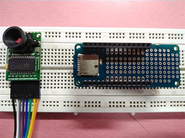

the ArduCAM Mini 2MP which is technically a shield housing the OV2640, a 2 MP image sensor that would normally come with 16 pins on its own without the shield. The advantage of this shield is that it simplifies the number of pins of the module to just 6 from the above mentioned 16, and hence simplifies I/O operations brilliantly with easily available open source code to run it on many different platforms including Arduino and RPi boards. Special shoutout to Jason Perry from Nova Scotia, an old friend who was kind enough to sponsor this camera sensor and the speaker that we are going to use later for the audio output. Thanks a lot, mate!
This camera roughly costs about 45$ as we had to get it imported from the actual manufacturer ArduCAM to get it.  That's also the reason why it took so much time for us to get our hands on this module, exactly 30 days from the date of ordering. So this caused a lot of delay in our blog posts, hope that we're not too late and we can cover up lost time very quickly.
So let's get down to business, we intend on getting our hands dirty in this blog post. The aim of this blog post is to get the ArduCAM Mini 2MP running with our MKR1000 and for it to run along with the SD Proto Shield to save images into an SD card. So let's get started with it!

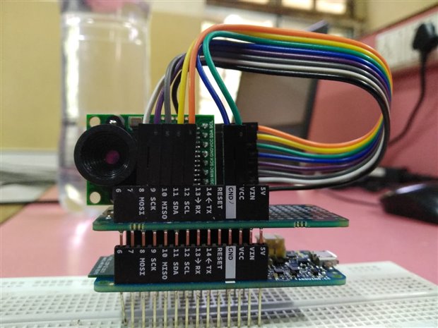

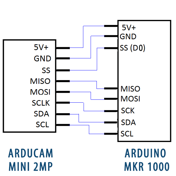

Next we have to connect the ArduCAM Mini 2 MP with the MKR1000 according to the following pin diagram -
The SD proto shield is also connected to store the images in the SD card card, for which the chip select is 4 (D4).
The next step is to connect the MKR1000 to our PC and upload the following code taken from the official ArduCAM library examples to save image to SD card -

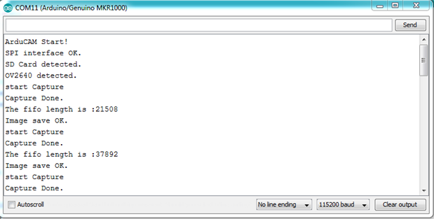

After this, we open the serial monitor to see the following information
As we can see, the serial monitor displays the initial set up completion of ArduCAM and detects the SD card along with it, then it goes ahead to to capture pictures in it's fifo. The fifo is ArduCAM's memory which is 384K in our ArduCAM Mini 2MP module. You can see the set of pictures saved in the SD card below -

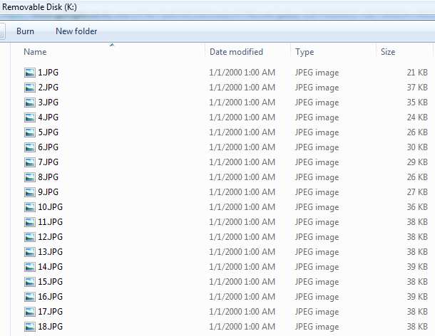

Some of the images taken by our module -

    pranjalranjan299 over 7 years ago in reply to stephalene14 +1
    This configuration worked for us as you can see in the images that are of the working ArduCam with the MKR1000 and also the rest of our project was built on this which you can read about in our next blog…
  • pranjalranjan299
    As far as I can remember, I have listed all the steps I used to get my camera working on the MKR1000. Perhaps you should try changing the female to male connectors as I had also got some issues that were…

    Sir please help me. I have an error: "File open failed" after capturing the image. Can you please help me what is wrong?

  • stephalene14
    stephalene14 over 7 years ago in reply to pranjalranjan299
    Thank you for the reply. I have tried all the digital pins from D0-D7 and still having the same error. Here is the code that I have altered from the code you provided. Hopefully you can help me with the error. Thank you so much for your help.
