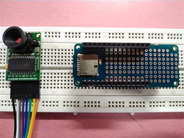

Welcome to our seventh blog post! We are back with our newest camera module from ArduCAM which is a cracking improvement over the OV7670 that we used for testing the Deep Learning model in the last blog post.
imageThis is called
the ArduCAM Mini 2MP which is technically a shield housing the OV2640, a 2 MP image sensor that would normally come with 16 pins on its own without the shield. The advantage of this shield is that it simplifies the number of pins of the module to just 6 from the above mentioned 16, and hence simplifies I/O operations brilliantly with easily available open source code to run it on many different platforms including Arduino and RPi boards. Special shoutout to Jason Perry from Nova Scotia, an old friend who was kind enough to sponsor this camera sensor and the speaker that we are going to use later for the audio output. Thanks a lot, mate!
This camera roughly costs about 45$ as we had to get it imported from the actual manufacturer ArduCAM to get it.  That's also the reason why it took so much time for us to get our hands on this module, exactly 30 days from the date of ordering. So this caused a lot of delay in our blog posts, hope that we're not too late and we can cover up lost time very quickly.
So let's get down to business, we intend on getting our hands dirty in this blog post. The aim of this blog post is to get the ArduCAM Mini 2MP running with our MKR1000 and for it to run along with the SD Proto Shield to save images into an SD card. So let's get started with it!
Let us start by providing some insight about ArduCAM - it is a startup company dedicated to open source hardware and software designing and manufacturing from China, especially for Arduino, Raspberry Pi camera solutions. It provides easy plug and play solutions for various boards and easily available library support on GitHub. It has camera sensors ranging from the 0.3 MP OV7670 to 8MP image sensors for RPi platform. Here we have chosen a 2 MP camera because it is optimal for our MKR1000 which will handle the tasks of saving images to SD card and also transmitting them to the model. A 5 MP is bound to get overbearing on the MKR1000 and it will also cause overheating.
The libraries for interfacing ArduCAMs with various platforms is available here - https://github.com/ArduCAM . We have used the library and examples for the Arduino boards stored in the first repository. The Arduino ArduCAM library has been tested for platforms like Uno, Nano, Mega etc but it is not preconfigured for our MKR1000. So it doesn't work without a slight modification in the code. The block of code required to be added to ArduCAM.h is -

Next we have to connect the ArduCAM Mini 2 MP with the MKR1000 according to the following pin diagram -
The SD proto shield is also connected to store the images in the SD card card, for which the chip select is 4 (D4).
The next step is to connect the MKR1000 to our PC and upload the following code taken from the official ArduCAM library examples to save image to SD card -
