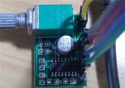

  2. PAM 8403 Amplifier (5V with Potentiometer)

                                       Speaker (8 Ohms, 3 Watts)                                                                                                                                                                      PAM 8403 Amplifier

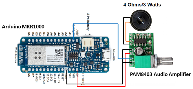

Pin diagram -

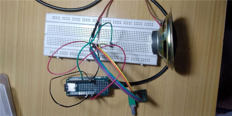

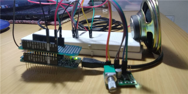

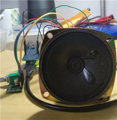

After connection -

Demonstration -
