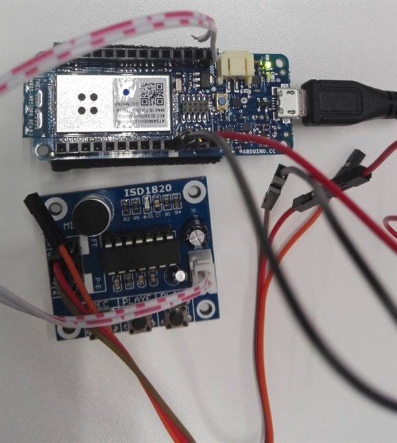

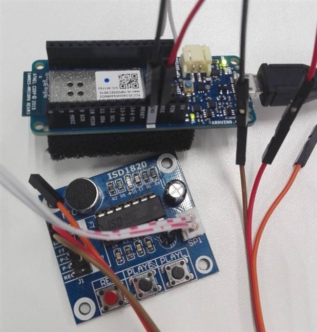

1. The ISD1820 is microphone module, the analogue value shall be turned into digital value for processing purpose.
Pin A0 is set as INPUT, fetching data form ISD1802.
int inputPin = A0;
The following codes do the job with adcTune function, the analogueRead(A0) pins is set for sound wave catching.

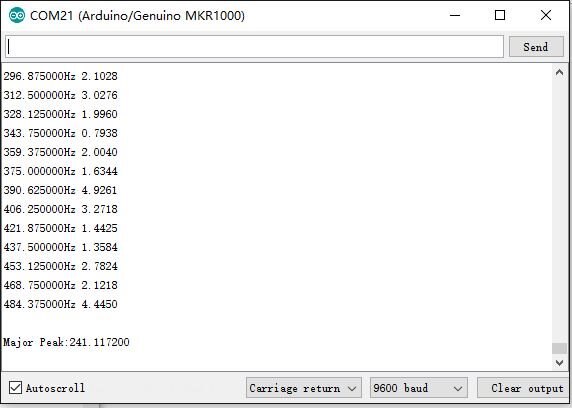

In this test, only peak frequency is printed. In fact , the spectrum is available for further encryption.
In function fftTune(), there are three sub-steps like FFT.windowing(), FFT.Compute(), FFT.ComplexToMagnitude(). After that, FFT.MajorPeak() can pick the peak frequency within the spectrum.
void fftTune(double *vReal,double *vImag, uint16_t samples)
         FFT.Windowing(vReal, samples, FFT_WIN_TYP_HAMMING, FFT_FORWARD);  /* Weigh data */
        FFT.Compute(vReal, vImag, samples, FFT_FORWARD); /* Compute FFT */
        FFT.ComplexToMagnitude(vReal, vImag, samples); /* Compute magnitudes */
        Serial.println("Computed magnitudes:");
        PrintVector(vReal, (samples >> 1), SCL_FREQUENCY);
        double x = FFT.MajorPeak(vReal, samples, SAMPLINGFREQUENCY);

    Nice update - I was wondering about the reading you got. Your previous post noted a frequency of ~2735 Hz. This shows around 241 Hz. I wonder what value you have for delay(CYCLETIME); Since that could…
  • fyaocn
    fyaocn over 8 years ago in reply to aspork42 +1
    Code in the sketch #define CYCLETIME 1 means only 1 ms is set. The 241Hz is test results when I tap the table. It varies around 200Hz~350Hz if you can try. As to frequency over 2kHz, that is a challenge…
  • fyaocn
    Code in the sketch
    #define CYCLETIME  1
    As to frequency over 2kHz, that is a challenge to Corex-M0 chip according to FFT alogrithm. I have to fine tunning the parameter for better performance.
    The 2735Hz is sample rates from the instruments, but the result in the design is different. But this is one of the purpose in the design.
    The primary goal in this design is that the input signal shall be stable instead of accurate.
    I am on another design on Instrument, accuracy means more Understanding to hardware, algorithm, wiring, PCB design and coding technique. Mix touch with fun.
  • aspork42
    aspork42 over 8 years ago
         delay(CYCLETIME);
    Since that could be limiting the output. I wonder what the trace would look like if you scope'd the A0 pin on Arduino to read what the ISD1820 is outputting.
