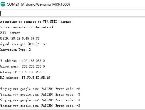

1. WiFi connection
Arduino MKR1000 has been Wi-Fi connectivity requiring minimal previous experience in networking.
It is based on the Atmel ATSAMW25 SoC (System on Chip). The ATSAMW25 is composed of three main blocks and one PCB Antenna
  • SAMD21 Cortex-M0+ 32bit low power ARM MCU
  • WINC1500 low power 2.4GHz IEEERegistered 802.11 b/g/n Wi-Fi
  • ECC508 CryptoAuthentication
  • 1x1 stream PCB Antenna.
Maybe it will make some effort if one try to use standard wifi library of arduino. While more appropriate choice is WiFi101 library, since it is totally compatible.
Here is one simple ping test, what you shall do is to fill in the ssid and password of your wifi. It shall be noted the ECC508 CryptoAuthentication is not standard configuration in wifi modules, it offer better security against unauthorized access.

The serial console output the following ,
The ping fails because the computer firewall block the process, so, it is Ok.

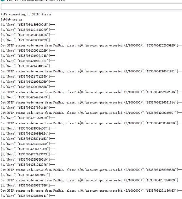

2. Pubnub service
Pubnub is evolving continuously. New service like chatengine is produced. While in this project IoT message is used for Securely monitor, control, provision and stream data between smart devices, sensor networks, hubs, and more. Trigger device action, monitor meta data, or stream and process incoming and outgoing data. PubNub provides the infrastructure and APIs for communication for any size IoT deployment.
It is a little more complex than wifi connection. But it is still as easy as you can image. Just fill the pubkey, subkey, pubnub channel. Then everything is Ok. The Arduino library packing everything.
For me, the challenge part is in far end of mobile application subscribe to the pubnub channel. I will take more time on it.
But the sketch returns well below.
The error code is fairly normal, since using public subkey as "demo" . The quota is exceed very soon. If using private subkey, the result will be good.
Here is the main part of the code.
