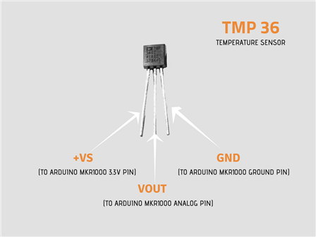

     There are a lot of resources available regarding the temperature sensor circuit connection with Arduino. But some are actually causing the temperature sensor to heat up which could eventually damage the sensor. So make sure you connect as mentioned here. The heating of the sensor issue will arise when you follow articles which show +VS to be connected to GND of Arduino and GND to 3.3V of Arduino. The TMP 36 temperature sensor's datasheet is available here. The pin diagram is snipped from the datasheet and given below.

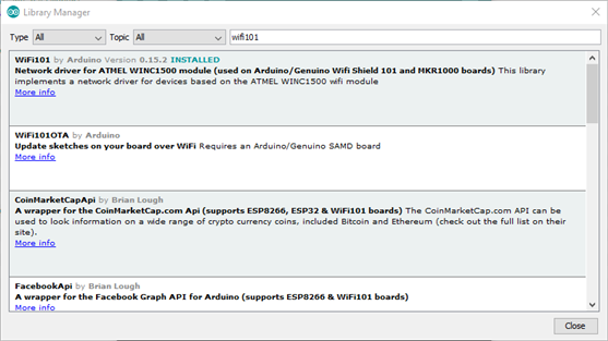

     The code for the 'IoT temperature measurement and monitoring' section of the smart wheelchair is provided below. For GitHub page for the same code, Click here. I have added comments for a better understanding of the code. You will need to add the 'WiFi101' and 'Thinger.io' using the library manager in your Arduino IDE (Preferably the latest version, I used V1.8.5).

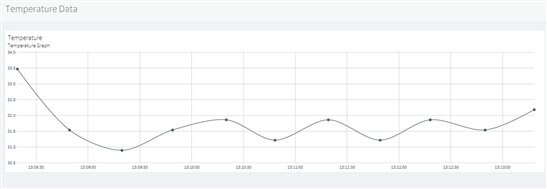

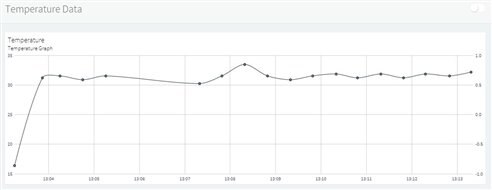

     Now that we have built our own IoT temperature monitoring system, it is time to enjoy our fruits of labor. Below are the video and images showing the final outcome.
The x-axis is time and Y-axis is the temperature in degrees Celsius

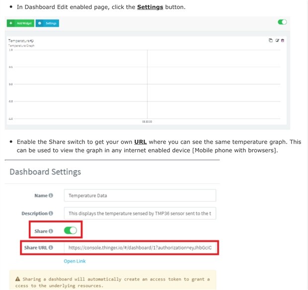

     There is a step at the last in the blog Steps for connecting Arduino MKR1000 with thinger.io for reading temperature data which is also given below. After doing so, we will have a dedicated URL which will also provide the same temperature time-series plot. This URL will be embedded into a mobile app. So as a smart feature of the wheelchair, the person in it can get updates on the temperature in a mobile app.
