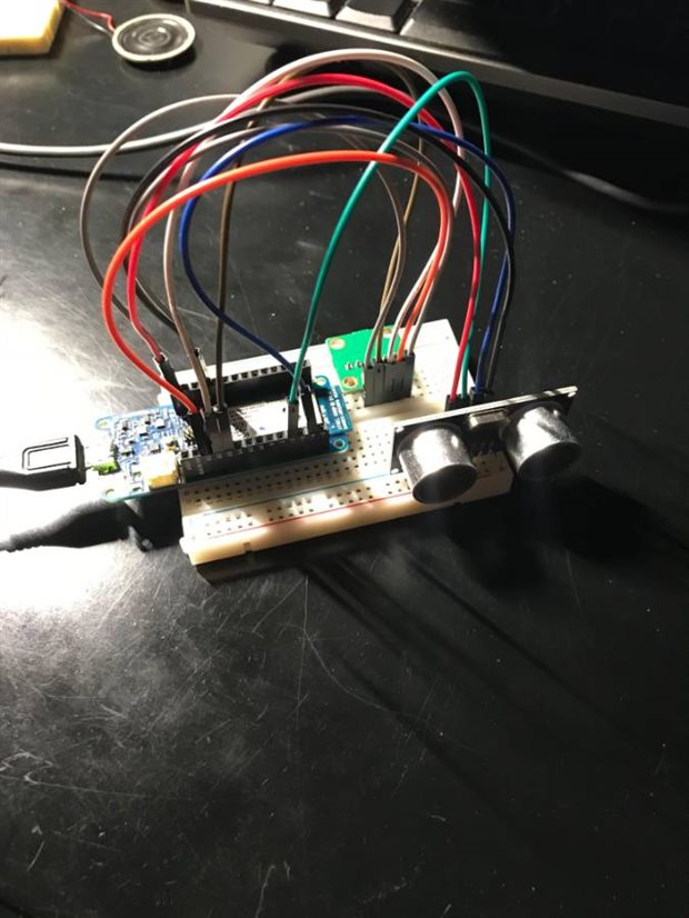

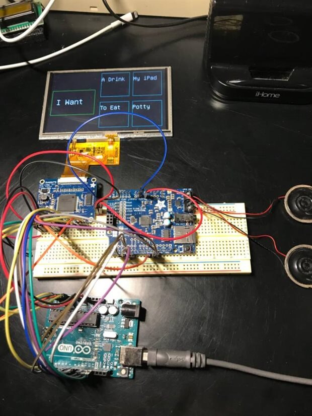

I completed my project! Here are two photos of the devices used in this project.
1. MKR1000 (Arduino Board included in KIT
2. ADXL335EB (Tilt Sensor - included in KIT)
3. HC-SR04 (Ultrasonic Sensor - included in KIT)
4. RA8875 (Video Module - Adafruit Item 1590)
5. 5" Touch Screen display  (Adafruit Item 1596)
6. MP3 Player Music Shield (Adafruit Item 1788)
7. Arduino UNO
8. Jumper Wires (included in KIT)
9. USB cables for both the UNO and MKR1000 (USB cable included for MKR1000 in KIT)
Also, if anyone knows where to submit this for the Competition, please let me know so I can make sure it is submitted on time!
Thanks!
As a side note, the SD Proto Shield never worked out of the box. I tried touching the solder points but it didn't help, I researched about it on different forums and found out that there were a batch of these that were defective and needed to be replaced.
That is why I purchased and used the VS1053 MP3 Player with SD shield attached and it worked just fine!

    I am resurrecting this project with a Mega 2560 and I am running into a bit of a problem.
    When I touch the screen, the section I press on the touch screen, plays the audio twice. I am figuring that it is counting when i touch the screen and when i let off of the screen.
    What I am reading is that this is probably a debounce problem. I am going to have to research on software debounce unless there is a hardware resolution like a capacitor in line with the input that goes into the RA8875 chip.
    I am not sure what to do at this point. Any suggestions would be appreciated.
    I am willing to send you my code to look at if you like. if you send me an email address, i can send it. I would rather not post the code on here till its all done.

    I'll PM you. We should post the findings back here so the community can see. I re-watched the video and it looks like some of them are likely double-playing. The arduino code from the Uno should be enough.
