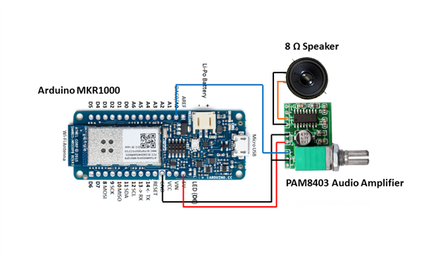

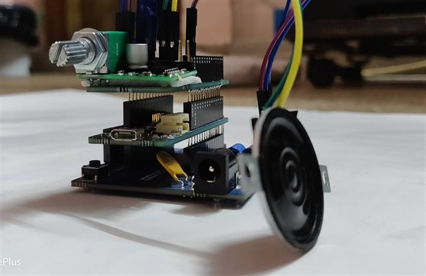

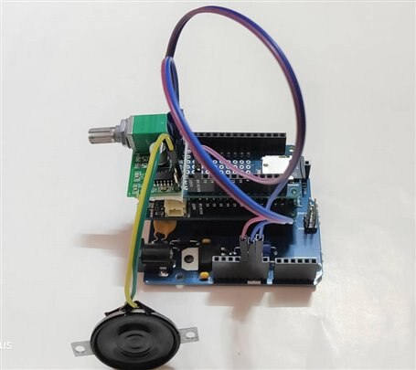

Here is my work on integrating SD Card Shield and PAM8403 Audio Amplifier to Arduino MKR1000. Which is the part of  "Smart Voice Synthesizer, Visualizer".
As per the design, the hand Gestures will be transformed into voice where this implementation play the key role.
Components Required
  • Arduino MKR1000
  • Arduino UNO shield
  • Arduino MKR1000 SD Card Shield
  • PAM8403 Audio Amplifier Module
  • Jumper Wire
  • Speaker
  • SD Card
The Circuit
Connect the SD card shield to connect Arduino MKR1000 and Audio Amplifier
SD Card should contain test.wave audio file.
