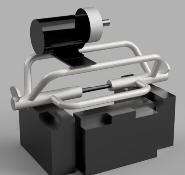

MOUNTING THE MOTOR
After assessing the Trike and mocking up its rear carriage in Autodesk Fusion 360, we elected to mount the motor to a 3/16" plate that was then bolted to the top bracing of the carriage.  It allowed for a direct shot for the new chain after cutting the trike basket.  It also would allow for installing the batteries low to keep the center of gravity of the trike low.
We found there was not enough clearance to install the new sprocket.  So, we elected to eliminate the original band brake at that center location and install a disk brake at the drive wheel.  We plan to make this actuate from the MKR1000 versus by cable.

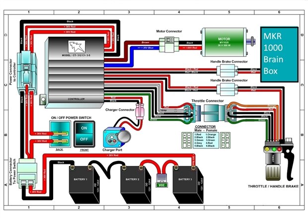

We wired the 3 batteries in series to create a 36V power source.
Here is the overview of the system.  Note:  At this point we don't have the MKR1000 Brain Box Shown in the diagram - so it's still dumb and dangerous!
Basically, the MKR1000 brain box we will make puts  3.3V to a transistor that, in turn, pulls in a relay.  The relay switches from its normally closed state to the open state.  Wired to the relay is the independent motor controllers brake interlock.  This, in turn, allows the motor controller to drive the motor.  Basically, we will hack one brake interlock to get interlocks on pedaling, speed, tilting, proximity, and alarm.  But first, we need to test it mechanically.

    Lower the Center of Gravity:   on our Raising Awesome Channel, we will weld in the battery brackets that will locate the batteries under the trike.  This will take the center of gravity as low as it can go and move it under the rider for added stability.
    I was wondering if there was room in front of the rear axle and slightly below the centreline to mount one battery each side.
    The further out you place these the more stable it will be. You're still stuck with a single battery but this could be at the same height at the rear.
