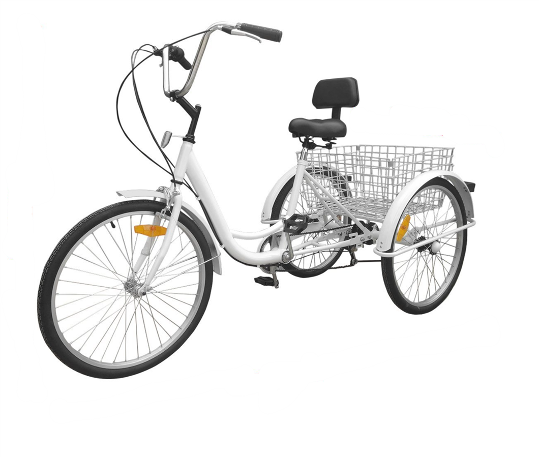

In this assistive technology project to take us back to the trails, we need to establish a means of cycling that addresses the following:
  • poor balance to keep the bike in one's own lane
  • weak grip with the left hand to squeeze the bike brake
  • inability to stand to "torque" up hills
  • inability to step over the center bar to mount the bike
  • general quick fatigue due to left leg pain
To pull this off, we will apply the following assistive technology:
  • Trade in the 2 wheeled bike for a 3 wheeled, low center bar trike
  • 36V 500 RPM motor geared for 11 mph
  • 36V motor controller and thumb throttle
  • (3) 12V batteries
  • MKR1000 IoT kit
  • Additional Design for a Cause Challenge Components
  • ESP8266
Key features of this Smart Trike will be:
  • Motor interlock due to over tilt
  • Motor interlock when either brake is applied
  • Motor interlock for objects too close
  • Motor interlock if stopped peddling
  • Power Assist braking
  • LCD display of speed, distance, travel time, and interlock status information
  • Garage door opener/closer
  • Data logging for speed, distance, travel time, interlock hits with identifying reason, and tilt
  • Bike Security Alarm
  • Retro Paperboy Arcade Portable - just kidding - that's for a future winter time build

    Great question.  This trike attracted me primarily because I saw about 4" of free keyed shaft exposed in the back and a platform that I could install a motor on.
    If I were not to motorize and MKR1000 it, after doing further research, I definitely would go for a low profile recumbent with two wheels in the back and one in the front.  I read an article by a manufacturer which I unfortunately can't find again right now.  It said that 90% of people like the recumbent, two wheel in the back style the best.  The manufacturer sold three types, so it seemed legit.  It said that having two wheels in the front makes for a very hard turning vehicle.
    The trike style we have has its issues.  One, it being a very inexpensive trike, it appears the front frame welds were not precise.  In turn, it is "yawed" out.  I had to modify how it bolted into the carriage to make it rideable, but I still need to do more to straighten it out.  If it were fabricated true, I'd have little complaint for what we are doing and where we plan to ride.
    On this style of trike, if one has ridden a bike for years, you will definitely feel the difference of not being able to lean into turns and side inclines.  It can give you the feeling that it will flip when turning-although physically you probably wouldn't.  We are installing our batteries low to help ensure that it can't happen.  I have concern thought that if it were to veer in a direction, it may be hard to steer it back center.
