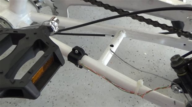

  • Pedal Sensor and Interlock
The pedal sensor is used to interlock the motor if the rider stops pedaling for any reason.  We still want to get exercise.  If we stop pedaling, the MKR1000 will assume we want to stop or want to be riding with extra caution.  Again, this double ensures that we won't start the throttle while our feet are not on the pedals which would surely cause injury.  It has a hall effect sensor and a rare earth magnet stuck to the pedal to switch the sensor - no glue required :-).

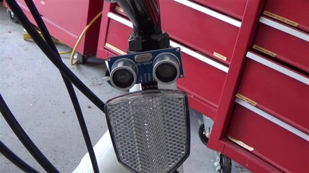

  • Proximity Sensor and Interlock
This proximity sensor will interlock the motor if anything is in front of the trike.  We don't want the motor to contribute energy into a collision.

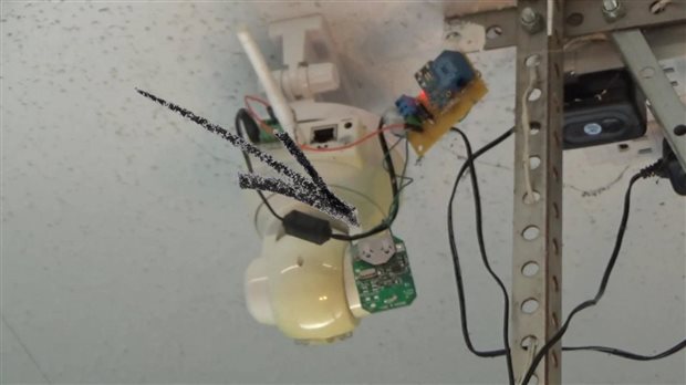

  • Garage Door Opener Receiver
The garage door opener receiver is a clever hack on a standard push button garage opener.  We built it a year ago.  We took apart an old opener and simply use a microcontroller to simulate the button press.  The microcontroller receives its trigger through either the IP camera built in web server or through IFTTT.com webhook triggered by the MKR1000.  That device merits a project vlog of its own.

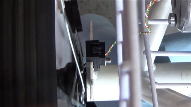

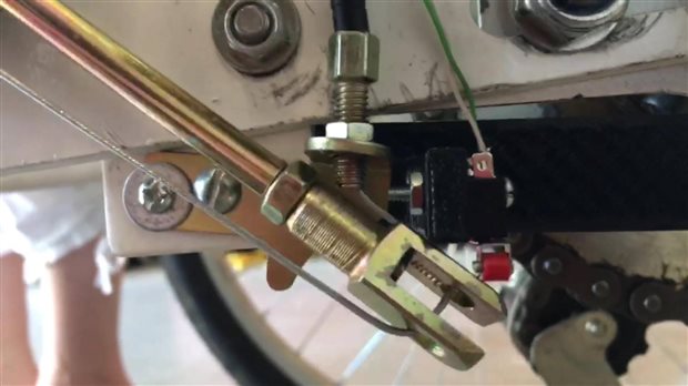

  • Braking Limit Switch and Interlock
The braking limit switch uses the physics of the motion of the brake lever pull on our new hydraulic brake to touch a limit switch.  This signals the MKR1000 to interlock the motor.  No more panicking and holding the brake and running the motor at the same time!  This feature wasn't shown in the video above, but hopefully it will show in a later release to YouTube.  It's one of the top two important interlocks.

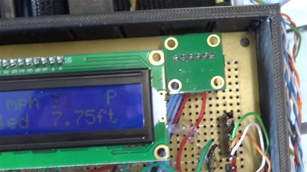

  • Tilt Sensor and Interlock
The tilt sensor simply soldered to the main circuit board provides the final interlock.  If going down a hill the motor will be cut off - or if the trike flips over.

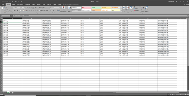

  • SD Card Output
For every interlock tripped or new high speed, we write out to a file.  This allows us to study the sensor data to calibrate for best ride quality and safety.
