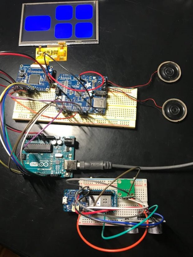

Hello all
I was able to get the RA8875 and the VS1053 to work with the Arduino UNO.
I also connected the HC-SR04 Ultrasonic Sensor and the ADXL335EB board to the MKR1000 to account for movement as well as distance from the MKR1000 itself.
I will be connecting both of these devices via the SDA/SCL connections for communications.
I took a photo just now of what is going on so far!
As you can see there are the touch screen buttons and I am scratching my head on how to get the image file off the SD card from the VS1053 to the TFT touch screen via the RA8875.
I have looked at code to do this but it doesn't work with my RA8875.
Also I need to just have the background be only one image file (a BMP file I already have) on the SD card ready to go.
Then when the "button" is pressed, it will play the audio file associated to that button. I tested the audio and it works and the blue buttons register X/Y touch coordinates.
I then need to get code to have the touch area to be over each part of the image that shows below on the display (it will replace the blue buttons at this time).
The border will be around each image (5 of them) that is on the BMP file similar to the buttons below.
Any assistance is appreciated.

    shabaz over 8 years ago +1
    Hi Rob, Unless there's an API that will accept the BMP file format (i.e. check the Adafruit library for the RA8875 board - but I'm fairly sure there isn't, I briefly checked the API but I may have missed…
    Hi Rob,
    Unless there's an API that will accept the BMP file format (i.e. check the Adafruit library for the RA8875 board - but I'm fairly sure there isn't, I briefly checked the API but I may have missed it, so please double-check yourself, I don't want to mislead - https://github.com/adafruit/Adafruit_RA8875/blob/master/Adafruit_RA8875.h  ), you will need to read bytes from within the file and send individual pixel instructions to the RA8875 board. It could take a few seconds to transfer (if you're lucky. It could take longer), depending on the speed of all the elements in the solution and the code. Anyway, maybe that's fine, if this just needs to occur once and the images remain static for a long time.
    I don't know what images you wish to show, but if you're in the final week, I also feel the same, that text may be easier.
    By the way, what was the issue that needed to be resolved to get both boards working? It could be helpful to know, to help others who try to use these boards.
    Personally, if I had to do it with this hardware combination, and had reduced time, then I'd use simple line art (vectors). For instance, to draw a house, could take just a few dozen co-ordinates stored in Flash on the microcontroller, no need to use the SD card. You've already figured out how to draw blue shapes with curves, so line art is much easier.

    Hi Shabaz,
    I was reading over your question about the issue I needed to resolve to get both boards working.
    It was a CS issue with both devices.I had to find pins that were not being used with the VS1053 so the RA8875 could use it.
    Since the VS1053 uses 8 pins (including the SPI pins) I had to select a specific pin for the Interrupt on the UNO board.
    Since pins 2 and 3 are the interrupt pins on the UNO, I made sure to use one for the RA8875 and one for the VS1053.
    I also had to make sure that the interrupt pins were different.
    I really had to move pins around to get them to work with the UNO by trying the RA8875 first to make sure that it worked.
    Since the VS1053 will sit on the UNO, I didn't have to pick pins at first.
    I then put the shield on a breadboard and used wires to select pins that worked with the UNO that were not the same wires for the RA8875.
    A lot of trial and error and once I got them both to work at the same time, I wrote down the pin configurations so I wouldn't forget them.
    I took your advice and went with a simple line vector with text to show the placeholders.
    I will work on the images to see what I can do to get them to load and not crash the system/reboot it.
    There are no error messages, the software just reboots.
    I know it isn't a hardware issue because the serial monitor doesn't reset like if I uploaded the code or pressed the reset button.
