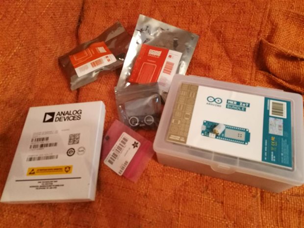

The Kit
The kit has arrived and has a lot of cool things inside! The full list of components of the kit can be found here Design for a Cause Challenge: The Kit
One of the first things I will be doing for this challenge is going through some of the starter projects for the Arduino MKR1000 to get to know it better!

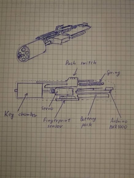

Barrel Mechanism
The barrel mechanism is the my first idea for this project, and here is the drawing I submitted with the application:
The simple idea was using either a servo or a stepper motor which would turn the barrel to the right position, and when that's done the user could pull out the key. The thing is in order for this work keys would need to be cut down to size and would have to be mounted to holders, which all adds a layer upon a layer, and doesn't make the device that appealing.

    genebren over 8 years ago +1
    Nice start to your design challenge project. With respect to your barrel approach, what if the barrel was slotted and held the key in place (once selected), then the user would use the device to insert…

    milosrasic98 over 8 years ago in reply to genebren +1
    Hi Gene, I see what you mean. It would probably work, but the thing is that would make the whole thing pretty bulky, that's the reason why I went with cutting the key heads off, to make it as compact as…
    Hi Gene,
    I see what you mean. It would probably work, but the thing is that would make the whole thing pretty bulky, that's the reason why I went with cutting the key heads off, to make it as compact as possible, but now that I think of it, if it were to have 2-4 keys in the barrel it could be made pretty compact. Thanks for the suggestion, I will look into it a bit more as well as the slider mechanism!
    Milos
    Nice start to your design challenge project.  With respect to your barrel approach, what if the barrel was slotted and held the key in place (once selected), then the user would use the device to insert the key and turn it in the lock.  This might eliminate the need to modify the key for usage.  Just a thought.
    Good luck,
    Gene
