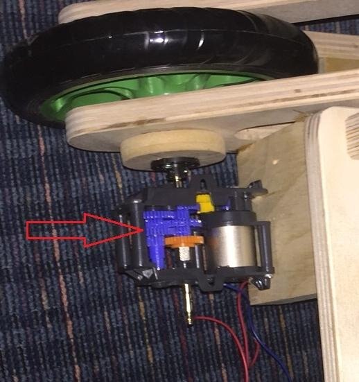

Welcome back for my 6th blog in the "Design for a Cause - Design Challenge". So far I have Seeing EyeDuino - Blog #1 Concept explained the concept to my design, Seeing Eyeduino - Blog #2 "Robot Chassis and more" made the chassis, very proudly created the Braille finger pad SeeingEyeduino - Working Braille Finger Pad : Blog #3 , hooked up the motors to drive the robot Seeing Eyeduino - Blog #4 Motors and more and finally got a very good start on the code to run the whole project Seeing EyeDuino - Blog #5 - Robot code .
So I have run into an issue. The motors to drive the robot aren't powerful/strong enough. They run great when they are free turning but when I put the chassis on the ground the gears slip. With more weight going to be put on the chassis I will need to upgrade the motors. This isn't to big of a deal, just have to go buy them (read further down for project changes).

So with this information I will be making some changes to my project:
1) Remove the motors from my project. This will allow the operator to go where they want and at the speed they want. When they stop at a street corner, so will the EyeDuino. The sensors will alert them on dangers and obstacles but the user has the control to make the decision on where to go. This will also make it possible to navigate steps easier.
2) Add coloured lights and sound to the project for alerts.
3) Change a lot of the coding I created to accommodate the updated design.
These changes will be well worth it, I want to create something that is useful for anyone to use, not a hindrance.
